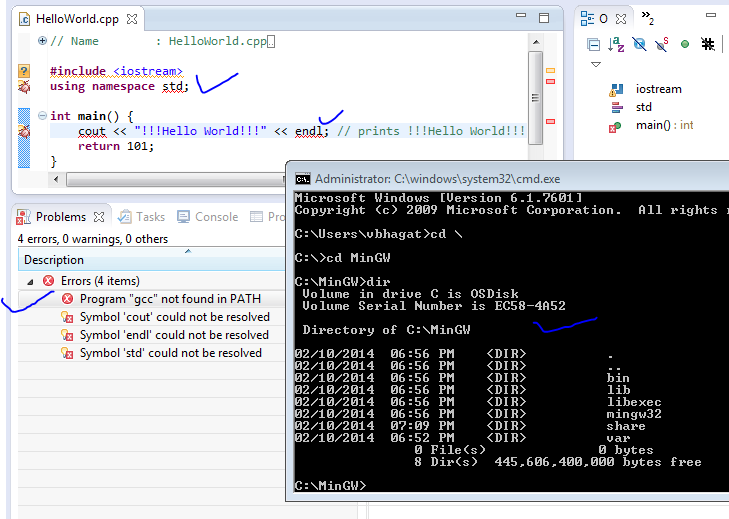

Re: g++ not found in PATH [message #1243465 is a reply to message #1067926] Mon, 10 February 2014 21:25 Go to previous messageGo to next message
This did not work for me. I followed the exact steps but I still continue to get the same error.
