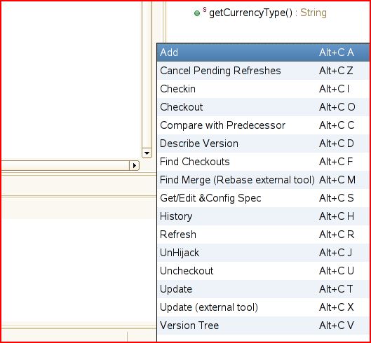

I tried using jface in my View:
private static final String REFRESH_ACTION_ID ="net.sourceforge.eclipseccase.views.configspecview.refreshAction";
IHandlerService service = (IHandlerService)getViewSite().getService(IHandlerService.class);
		refreshAction.setImageDescriptor(AbstractUIPlugin.imageDescriptorFromPlugin("net.sourceforge.eclipseccase.ui", "icons/full/refresh.gif"));
		refreshAction.setToolTipText("Refresh");
		//TODO: 3571949 Shortcut for Save/Clear/Refresh actions in configspec editor
		refreshAction.setActionDefinitionId(REFRESH_ACTION_ID);
		service.activateHandler(refreshAction.getActionDefinitionId(), new ActionHandler(refreshAction));
I have the following in my plugin.xml
	<extension point="org.eclipse.ui.commands"
       id="net.sourceforge.eclipseccase.views.configspecview.refreshAction"
       name="RefreshCsAction">
 	</extension>
	<key platform="gtk" commandId="net.sourceforge.eclipseccase.views.configspecview.refreshAction"
			 schemeId="org.eclipse.ui.defaultAcceleratorConfiguration"
			sequence="Alt+C K">
		</key>
When I have my view active and press ALT+C a tooltip pops up but but it does not show
ALT+C K. And even if I press ALT+C K nothing happens.
Any ideas what I am missing here?
br,
//mike
