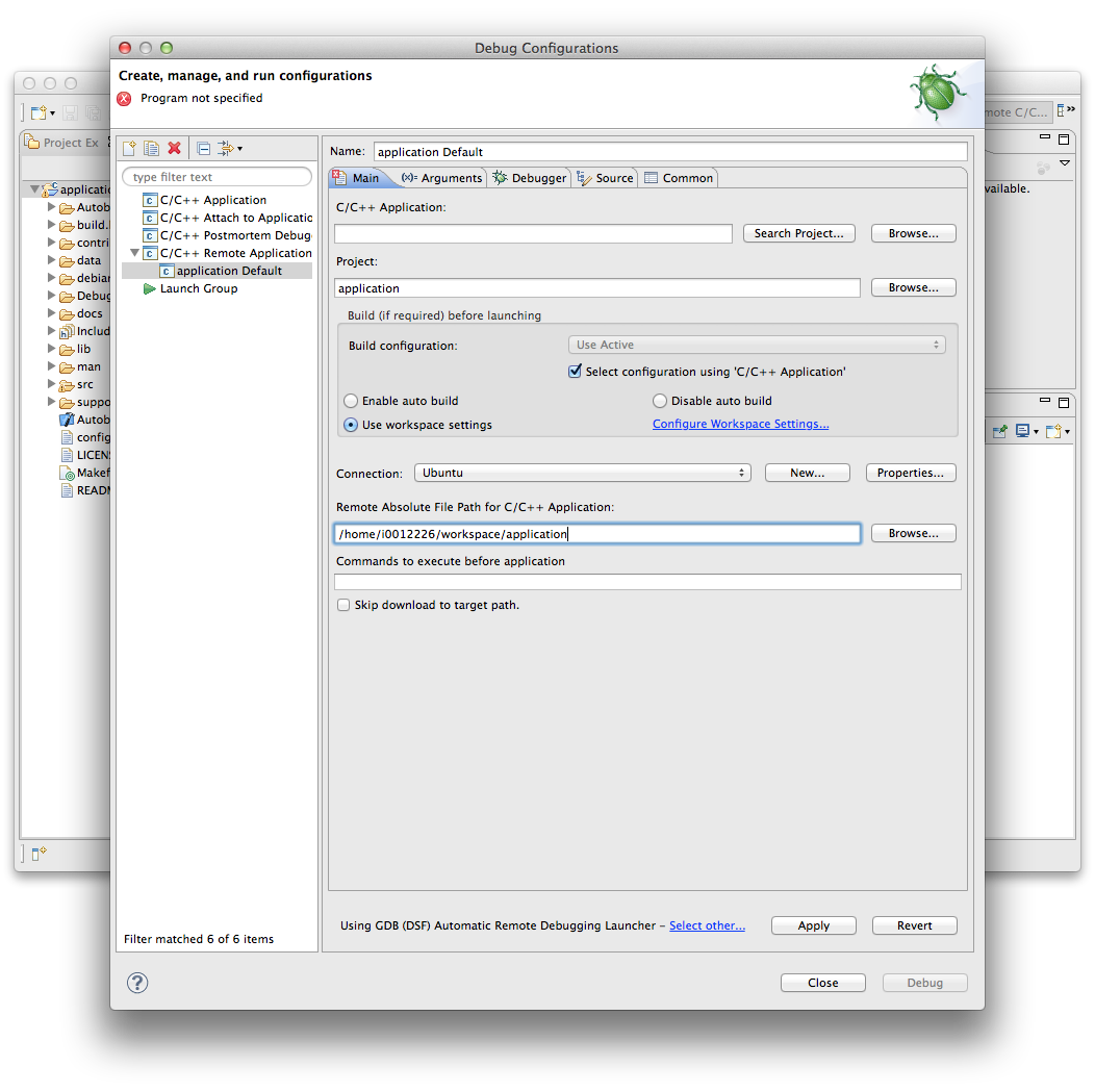

Now is where I hit my issue. In the "Main" tab of the launch configuration, it is asking for a C/C++ Application. When I click Search Project everything is blank. When I click browse, the local file browser is displayed.
index.php/fa/12682/0/
Since my application binary is on a remote server, I'm not sure why "Browse" would bring up the local directory.
Any help / ideas would be greatly appreciated.

When you debug a remote application you have gdbserver running on the remote host, and GDB running on the local host. GDB needs to know about the debug symbols and therefore needs to know where your application is, on the local file system.
Another way to say this is that you need two binaries: one on the local host and one on the remote host.

Thank you for the response. So basically my thoughts on what remote debugging could do was wrong.
Since I'm targeting Ubuntu and using OS X to edit the source via RSE, I can't really build the application locally.
If I had another Ubuntu box, I could build the application locally, and then it would transfer over to the remote machine and then I could debug correct?

I haven't tried from two different operating-systems, but I know you can debug a 64-bit target from a 32-bit host, and vice-versa. To do that, you would use the 64-bit binary of the target also on the host, and GDB would figure things out.
Why don't you try using the Ubuntu binary for GDB on your OS X? The binary cannot run, but GDB only needs it to look at debug symbols. So, take it from your target and put it on your host, and point GDB to it.

Okay, I just tried that, but it looks like GDB on OS X might not be able to handle a binary from a different platform:
Error in final launch sequence
Failed to execute MI command:
-file-exec-and-symbols /Users/jsm174/Desktop/application
Error message from debugger back end:
"/Users/jsm174/Desktop/application": not in executable format: File format not recognized

This is now a use-case for GDB. If you can get GDB to do this remote debugging, Eclipse will support it.
So, when you want to get GDB to debug a different remote target, you need to compile GDB differently.
I've never compile GDB on OS X but on Linux I add the --enable-targets=i686-pc-linux-gnu or --enable-targets=x86_64-pc-linux-gnu to the 'configure' command when I want to debug a different remote target. You can even use --enable-targets=all to play it safe.

Thanks for getting me down the right path. I'm getting closer!
I downloaded GDB, compiled it with --enable-targets=all.
Then I got:
"/Users/jsm174/Desktop/application": not in executable format: File format is ambiguous.
Matching formats: elf32-i386-nacl elf32-i386-sol2 elf32-i386-vxworks elf32-i386.
Use "set gnutarget format-name" to specify the format.
So I modified .gdbinit to include "set gnutarget elf32-i386" and then got:
I'm sorry, Dave, I can't do that.  Symbol format `elf32-i386' unknown.
I'll keep working on it!

Nice progress. You're beyond anything I've done, so I can't help much more. However, to speed your progress, you can skip using eclipse and simply start gdb from the console specifying the binary:
> gdb /Users/jsm174/Desktop/application
I'd expect you to get the same error as what Eclipse is showing you, but a little faster Smile
Thanks for reporting back your progress, it will prove helpful to others.
