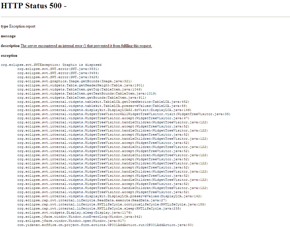

RAP version: RAP2.0M1
exception reference attachment.
thanks a lot.

Re: Throws unexpected "Graphic is diposed" exception [message #988443 is a reply to message #988272] Thu, 29 November 2012 17:00 Go to previous messageGo to next message
This can happen if the same image is used in two sessions and gets disposed in one of the sessions. Check you're creating new images for each session when setting the column header image.

Re: Throws unexpected "Graphic is diposed" exception [message #988492 is a reply to message #988460] Fri, 30 November 2012 03:52 Go to previous messageGo to next message
That's the problem. Your ImageRegistry is stored in a static variable, so it, and all the images inside it are shared between sessions.
