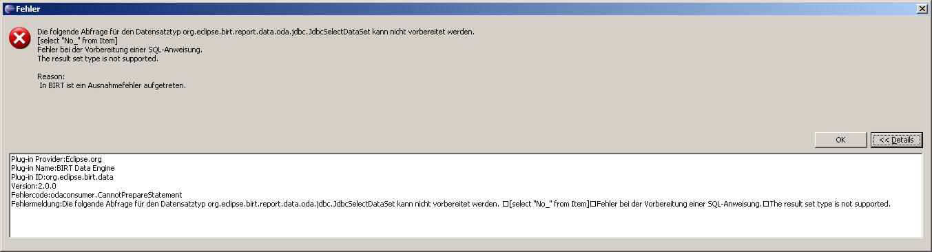

I try to get a JDBC-ODBC connection to work.
What I succesfully could do is creating a datasource:
DriverClass: sun.jdbc.odbc.JdbcOdbcDriver (Sun JDBC-ODBC Bridge Driver)
Database-URL: jdbc:odbc:MyODBC_DSN
Username: TestUser
Password: test
If I click on TestConnection it says me: Connection successful.
But If I do a simple query on a Table:
select * from Item
It gives me an error message within the dataset-wizard-->Result preview: ...
The result set type is not supported ...
(see attachment)
So what does it mean: The result set type is not supported?
Any idea is highly appreciated!

Re: BIRT JDBC and ODBC [message #141977 is a reply to message #141860] Thu, 09 March 2006 06:50 Go to previous messageGo to next message
Hello Vladimir,
sorry I did not mention.
I use Navision Attain Native C/SIDE database which comes with a C/ODBC
driver.
Any ideas?
