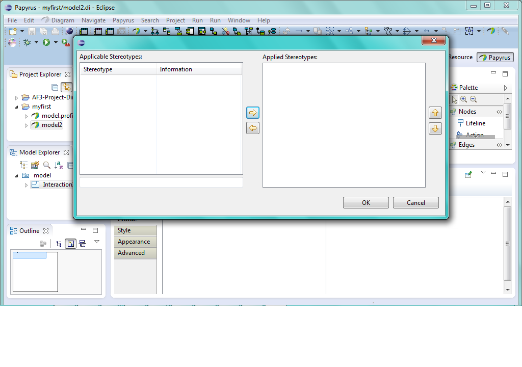

Re: My question to specialist of MARTE [message #985869 is a reply to message #985777] Fri, 16 November 2012 08:59 Go to previous messageGo to next message
Hello Lorea,
i followed the steps but i didn't see this option:"apply registered profile"
Please see attachment
what is the steps to activate this option?
Best Regards
Ann
  • Attachment: apply.png
    (Size: 112.39KB, Downloaded 307 times)
Re: My question to specialist of MARTE [message #986060 is a reply to message #985777] Sat, 17 November 2012 18:00 Go to previous messageGo to next message
Hello lorea,
thank you Smile this is the first time that i see something related to MARTE/Papyrus.
1-before,i didn't know that it is necessary to click on model in the model explorer first and then "registered profile" activated to click
2-as i understood it seems that when use standard stereotype of MARTE we don't need to create profile only create new model and then apply the appropriate registered subprofile.
only create profile when we need extension not supported by standard profile such as MARTE and SysML and then apply it to model?
is this right?
Best Regards
Ann
