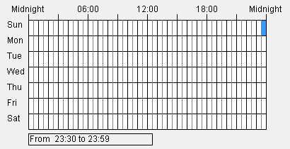

I encounter a component which Jubula can't recognise, the component is to set the Calendar time by draging the mouse from one point to another point. But I see there only drag action in the Jubula library, which seems to drag a component from one place to another. So I want to use the Mouse Down then Up action to achive this, but I don't know how to do this? Is there any instructions to write the Mouse Down and Mouse Up action? Thanks a lot.

There are also drop actions in the library: every drag action also has a corresponding drop action.
HTH,
Alex
