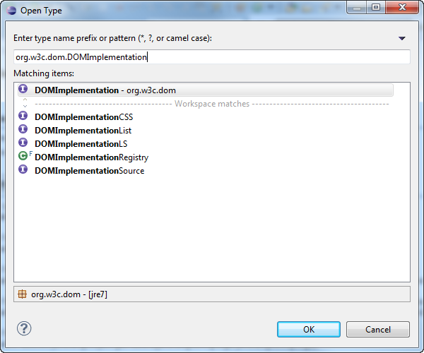

When you select your project bob and do Navigate > Open Type (Shift-Ctrl-T) and type the name of the class in question, do you see multiple occurrences?
Re: Class Loader problem with batik: How to search dependencies ? [message #932724 is a reply to message #932298] Thu, 04 October 2012 07:17 Go to previous messageGo to next message
No only one file... (see attached)
So it is definitely a problem of ClassLoader ? I found one day on a forum someone explaining that you can ask for a class to be loaded by a different ClassLoader than the rest of the project. But I cannot find it today.
Re: Class Loader problem with batik: How to search dependencies ? [message #933002 is a reply to message #932724] Thu, 04 October 2012 12:42 Go to previous messageGo to next message
Alright, so your project seems to be configured alright and the only type of that name comes right from the JRE, not any user library.
I'm not sure if classes from the JRE should actually be loaded by the DefaultClassLoader, but that question would best be answered by some Equinox folks at http://www.eclipse.org/forums/index.php/f/31/
