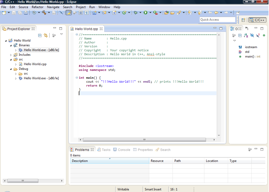

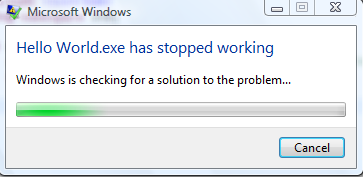

See the attachments.
How do I fix this and actually get an output on the console?

probably the "missing dll" problem:
http://www.eclipse.org/forums/index.php/mv/msg/369581/902554/#msg_902554
This may also help:
http://stackoverflow.com/questions/4984612/program-cant-find-libgcc-s-dw2-1-dll
regards,
Klaus
