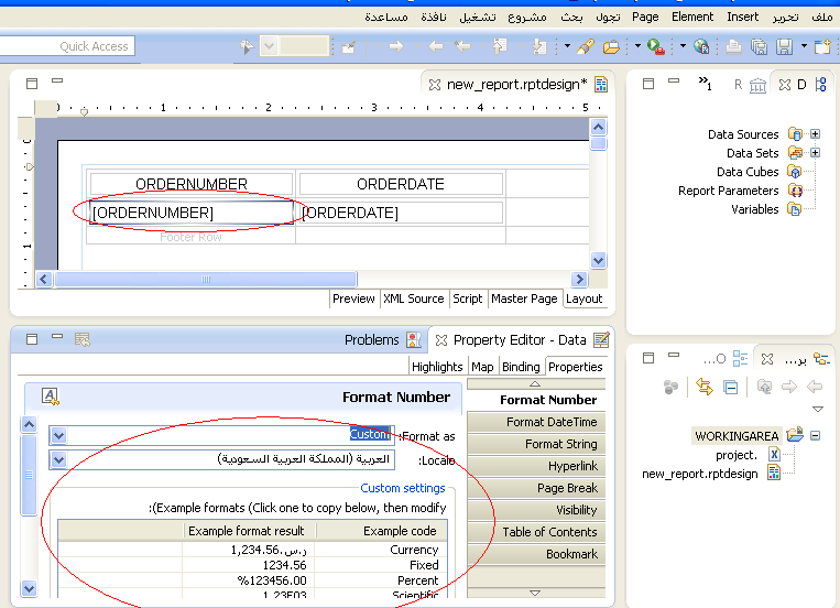

Hi Jason
Thank you for the quick reply.
Here is the screenshot as requested. Let me know if you still more information.
index.php/fa/11628/0/
  • Attachment: arabic.JPG
    (Size: 63.18KB, Downloaded 2125 times)

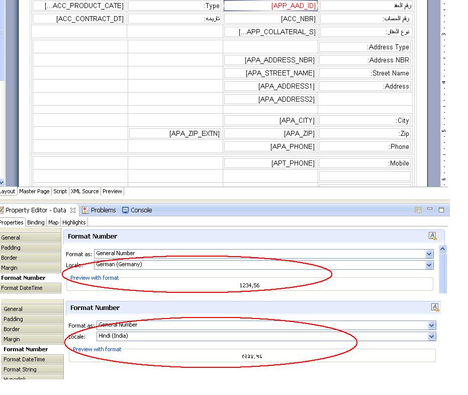

If you change the locale to something like German does it work?
Jason
Re: Arabic [message #926971 is a reply to message #926568] Sat, 29 September 2012 01:47 Go to previous messageGo to next message
I have attached here a screenshot for German I also tried the Hindi.
index.php/fa/11660/0/
  • Attachment: arabic2.JPG
    (Size: 113.75KB, Downloaded 2226 times)
Re: Arabic [message #929610 is a reply to message #926971] Mon, 01 October 2012 11:58 Go to previous messageGo to next message
Those look correct. Am I missing something?
Jason

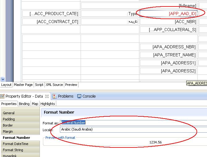

Hi Jason,
Thank you for the answers you have provided.
Today I got another xp machine and installed the same BIRT(JUNO) 4.2.1 on it. I also installed the ARABIC language pack.The the same result the number are in english.
I use the eclipse.exe -nl ar switch , the same result the numbers are in english. I attache here a screenshot
Here is my setup
windows xp sp2, sp3
BIRT 4.2.1 (JUNO), one with arabic language pack
Could there be something on fonts...xml file to tweak
index.php/fa/11683/0/
  • Attachment: arabic.bmp
    (Size: 1.21MB, Downloaded 2463 times)

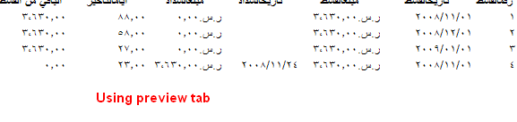

Re: Arabic [message #930571 is a reply to message #929610] Tue, 02 October 2012 08:49 Go to previous messageGo to next message
Hi Jason,
At last I arrived with the dose to my headache.
It has something to do with windows xp settings.
Windows xp settings
1.) Control panel regional setting->Regional Options->Numbers tab . On the Digit substitution field = Context value
2.) Control panel regional setting->Regional Options tab , beside customize button choose entry Arabic(Saudi Arabia).
and whala , you get arabic numbers rendered correctly, this is in preview tab.

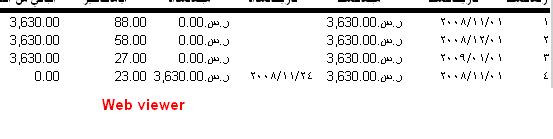

If you run in the View report in Web viewer, english number are displayed.
What could be the problem?
Re: Arabic [message #930871 is a reply to message #930571] Tue, 02 October 2012 14:16 Go to previous message
Can you open a bugzilla entry for this? I am not certain this is supported in the viewer.
