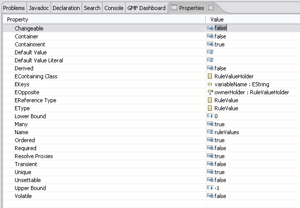

I add and remove attributes from a displayed collection node.
The add updates ok, but when I do the delete its gets removed underneath
but not on the diagram.
If I close the diagram and reopen the attribute has gone.
I guess I need to trigger an event, but just seems odd that the add works
and the delete doesn't
Code for add and remove below:-
aValueHolder.getRuleValues().removeAll(deleteList);
I have also done a for loop and rused the single object remove but no joy.
aValueHolder.getRuleValues().add(newRuleValue); << this works ok.
Any clues ?
The ecore setup for the attribute is attched if that helps.

Re: Collection doesn't update on delete [message #125287 is a reply to message #124523] Thu, 10 May 2007 07:01 Go to previous messageGo to next message
Originally posted by: evaandoli.dodo.com.au
Does this give any clues.
protected void refreshSemantic() {
List createdViews = refreshSemanticChildren();
makeViewsImmutable(createdViews);
The top line of the method ( List createdViews = refreshSemanticChildren();)
return null.
Is this right in the case I am talking about ?
I'm guessing the issue seems to be that my item is orphand. Its seems to be
null in the collection.
Does that sound right ?
Anyway any help would be good,
Stu
"Alex Shatalin" <vano@borland.com> wrote in message
news:3c3172e6134b98c95ec534923f89@news.eclipse.org...
> Hello stu,
> So, can you debug handleHotification emthod a bit more to see why
> corresponding element is still a child of diagram node?
> BTW, which version of GMF do you use?
> Alex Shatalin
Re: Collection doesn't update on delete [message #125298 is a reply to message #124523] Thu, 10 May 2007 07:02 Go to previous messageGo to next message
return null.
Stu

Re: Collection doesn't update on delete [message #125321 is a reply to message #125298] Thu, 10 May 2007 07:54 Go to previous messageGo to next message
Ok one more bit of info.
When it picks up the item as an orphan (which im guess is right).
The following two things return false.
In protected final boolean deleteViews( Iterator views ) {
" shouldDeleteView(view) " returns false as the view is not
view.getElement().eIsProxy();
So the element is not an eIsProxy() what does that mean ?
I read the doc just did really get it:-
* <!-- begin-user-doc -->
* Indicates whether this object is a proxy.
* <p>
* A proxy is an object that is defined in a <code>Resource</code> that has
not been loaded.
* An object may be a proxy either because proxy resolution was disabled
* when the object was accessed (see {@link
#eGet(EStructuralFeature,boolean)})
* or because proxy {@link org.eclipse.emf.ecore.util.EcoreUtil#resolve
resolution} failed.
* </p>
* @return <code>true</code> if this object is a proxy or <code>false</code>,
otherwise.
* @see Resource#unload
* @see org.eclipse.emf.ecore.util.EcoreUtil#resolve(EObject,
org.eclipse.emf.ecore.resource.ResourceSet)
* @ignore
* <!-- end-user-doc -->
* @model
* @generated

Re: Collection doesn't update on delete [message #125387 is a reply to message #125321] Thu, 10 May 2007 08:03 Go to previous messageGo to next message
Hello stu,
Aha! This is an old problem and it is already fixed in GMF 2.0 (AFAIU from
the uge trace you post you are working with GMF 1.0.1).
Alex Shatalin
