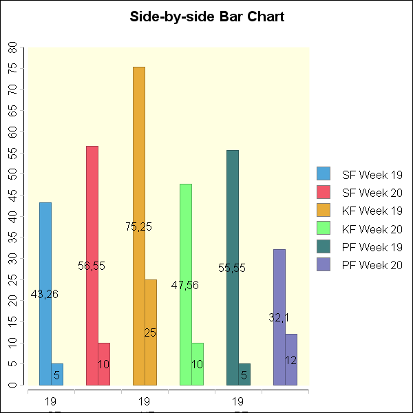

Re: [chart] with multiple categories (on x) [message #909445 is a reply to message #909208] Fri, 07 September 2012 06:47 Go to previous messageGo to next message
moritz du is currently offline moritz duFriend
Messages: 102
Registered: February 2010
Senior Member
thx again Jason,
i opened it in eclipse (created an report project first). Only the "Layout" and the "XML Source" tabs are showing something.
On Layout tab a normal stacked chart is shown - without special labels on x. Can you please give me a hint what to do or how to get multiline x-labels?
and a hint how to integrate such stuff into my java code would be also much appreciated.

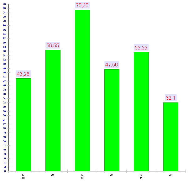

Re: [chart] with multiple categories (on x) [message #909721 is a reply to message #909445] Fri, 07 September 2012 16:38 Go to previous messageGo to next message
Jason Weathersby is currently offline Jason WeathersbyFriend
Messages: 9167
Registered: July 2009
Senior Member
If you imported the report, you should have layout, Master Page, Script, XML Source and Preview tabs. If you create a new report do you get those? You can always select the xml tab and copy and paste the report contents in. Specifically this was done with chart script. Select the chart and click on the script tab:
last = "";
function beforeDrawAxisLabel( axis, label, icsc )
importPackage(
Packages.org.eclipse.birt.chart.model.attribute.impl );
importPackage(
Packages.org.eclipse.birt.chart.model.attribute );
if( axis.getType() == AxisType.TEXT_LITERAL ){
var cp =label.getCaption().getValue();
if( cp.substr(0,2) == last ){
label.getCaption().setValue(cp.substr( (cp.length()-2)));
}else{
label.getCaption().setValue(cp.substr( (cp.length()-2))+"\n\r "+cp.substr(0,2));
last = cp.substr(0,2);

Re: [chart] with multiple categories (on x) [message #910643 is a reply to message #909721] Mon, 10 September 2012 06:33 Go to previous messageGo to next message
Messages: 102
Senior Member
thx jason,
i added the script to script tab of your report "adjustxaxislabelsmultiline". but what now? the preview tab and "view report" remains empty. (on saving eclipse had to convert the report to new version of birt - i use 4.2)

Re: [chart] with multiple categories (on x) [message #911259 is a reply to message #910955] Tue, 11 September 2012 08:59 Go to previous messageGo to next message
Messages: 102
Senior Member
the tab(preview) and the view(report viewer) are there but both are empty. On layout tab i see a chart with stacked bars but with normal labels (A...E) and KPI1, KPI2 in legend.
i installed all but the wtp plugins.
Re: [chart] with multiple categories (on x) [message #911408 is a reply to message #911259] Tue, 11 September 2012 14:37 Go to previous messageGo to next message
Messages: 9167
Senior Member
I may be missing something, but can you create a report using the sample db? I am trying to determine if you have a working designer. If you select the xml tab does it show the report xml?
Jason
Re: [chart] with multiple categories (on x) [message #911687 is a reply to message #911408] Wed, 12 September 2012 06:04 Go to previous messageGo to next message
Messages: 102
Senior Member
the xml tab shows exactly the file that you attached "adjustxaxislabelsmultiline.rptdesign".
I just tried some of the other "view report" options and most of them seem to work!
It works as long as i don't use "View report in web viewer" or preview.
No i see the second line on x-Axis "KF", "PF", "SF" - at last.
Can you please give me some additional advice how to integrate this script? Should i safe beforeDrawAxisLabel function in a text file or as string in java?
And what is the relation between afterDataSetFilled (you said i should add this to java) and beforeDrawAxisLabel?

The x-axis does not have two labels, it has one that that the script splits into two lines. From a Java perspective this would look like:
TextDataSet dsStringValue = TextDataSetImpl.create( new String[]{
"SF Week 19", "SF Week 20", "KF Week 19", "KF Week 20", "PF Week 19", "PF Week 20" } );
Series seCategory = SeriesImpl.create( );
seCategory.setDataSet( dsStringValue );
So this script:
last = "";
importPackage(
importPackage(
}else{
So for the first label that comes in this line:
puts the week number on top and the Fial number on the bottom. The second label will just put the week number on top:
The reason I posted the afterdatasetfilled example was to show you how the data for a chart could be made to be dynamic if you wanted it to.
Jason

thx again,
i was confused by the script-code:
sourcedata[0][0] = "SF";
sourcedata[0][1] = 19;
sourcedata[0][2] = 1085;
sourcedata[0][3] = 1018;
sourcedata[0][4] = "grp1";
this made me think that you give different labels. Meanwhile i played around a bit with
ChartEventHandlerAdapter.beforeDrawAxisLabel(Axis axis, Label label, IChartScriptContext icsc)
(using the normal java chart examples)
My first try was just to print out the labels set - but all were empty! Then i forced all to same value:
    public void beforeDrawAxisLabel(Axis axis, Label label, IChartScriptContext icsc) {
        // TODO Auto-generated method stub
        Label la = LabelImpl.create();
        la.setCaption(TextImpl.create("blubber"));
        super.beforeDrawAxisLabel(axis, la, icsc);
but this didn't change the chart in any way (all labels remains the "category values" and "series identifier in legend").
Is this probably the cause why you used "IDataRowExpressionEvaluator" in your example?

I am back from vacation so better late than never: Thank You!
I tried your code first by simple merging the code with "StandAloneChart" (from an Example-Zip Package). i simply substituted createStackedBar() method with the code you gave: the result:
index.php/fa/11727/0/
As you see the result is not the same. But on first sight the results reflects exactly the script: <weeknumber>+ "\n\r " + <Region>
So Region is in next line (not always) with one space-character before region's name. (since your first answer i asked myself how your script centers the next line)
Since i have to rewrite the script for my special use case this problem is not a real "problem"

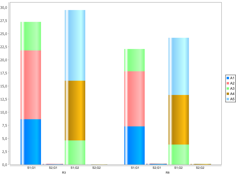

but
A second and more eminent problem occurred if i tried to adopt your solution to other examples (more similar to my use case): i substituted "createStackedBar()" with the code given in "Side By Side Bar" example (first example in Birts' Chart Examples view in eclipse). Then i just added the setscript() and copied the data from your example:
index.php/fa/11726/0/
so for some reason the second line is cut off - how to solve this problem?

Did you use these two lines?
xAxisPrimary.getLabel( ).getCaption( ).getFont( ).setSize(6);
xAxisPrimary.setLabelSpan(30);

no -
THX! that solved the problem.
do you have any hints about centering the second line. are there any means to get the center position from a group of bars (in your example 2 bars but in general one group has n bars)?
Re: [chart] with multiple categories (on x) [message #934166 is a reply to message #933689] Fri, 05 October 2012 18:19 Go to previous messageGo to next message
Messages: 9167
Senior Member
This is a bit tougher. In the beforeGeneration you should be able to get the number of series count (in this case bars)
//global bar count
bar_count=0;
function beforeGeneration(chart, icsc)
importPackage( Packages.org.eclipse.birt.chart.model.attribute );
xAxis = chart.getBaseAxes()[0];
yAxis = chart.getOrthogonalAxes( xAxis, true)[0]
seriesDef = yAxis.getSeriesDefinitions().get(0)
runSeries = seriesDef.getRunTimeSeries();
bar_count = runSeries.size();
You should be able to use bar count in your script as it runs later. You should be able to convert this script to Java as well.
Take a look at this post to see how wide a datapoint set will be:
http://birtworld.blogspot.com/2012/06/birt-area-chart-modifications.html
You should be able to come up with a calculation to add a number of spaces.
Jason
