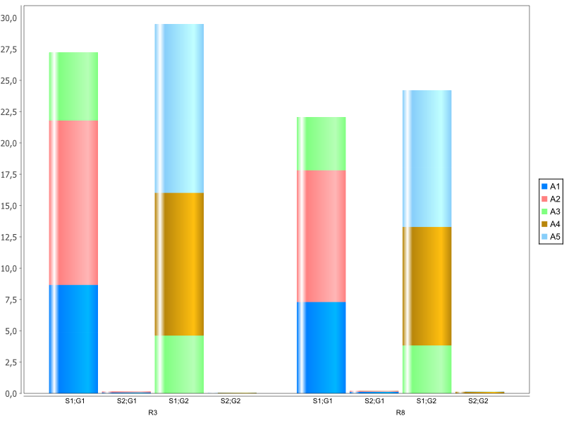

[chart] with multiple categories (on x) [message #908333] Wed, 05 September 2012 03:25 Go to next message
i need to visualize pivot tables (cross tables) in bar charts. i just switched from jfree chart (mainly beacuse of bad svg output), but with it i created such a chart:
index.php/fa/11388/0/
Is it possible to get multiple categories on x-Axis (a hierarchical grouping)?

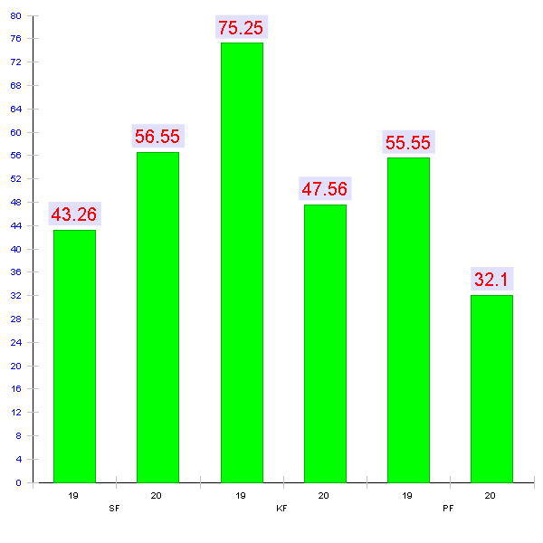

Re: [chart] with multiple categories (on x) [message #909208 is a reply to message #908875] Thu, 06 September 2012 14:27 Go to previous messageGo to next message
Take a look at the attached example.
Jason

Re: [chart] with multiple categories (on x) [message #909721 is a reply to message #909445] Fri, 07 September 2012 12:38 Go to previous messageGo to next message
If you imported the report, you should have layout, Master Page, Script, XML Source and Preview tabs. If you create a new report do you get those? You can always select the xml tab and copy and paste the report contents in. Specifically this was done with chart script. Select the chart and click on the script tab:
last = "";
function beforeDrawAxisLabel( axis, label, icsc )
importPackage(
Packages.org.eclipse.birt.chart.model.attribute.impl );
importPackage(
Packages.org.eclipse.birt.chart.model.attribute );
if( axis.getType() == AxisType.TEXT_LITERAL ){
var cp =label.getCaption().getValue();
if( cp.substr(0,2) == last ){
label.getCaption().setValue(cp.substr( (cp.length()-2)));
}else{
label.getCaption().setValue(cp.substr( (cp.length()-2))+"\n\r "+cp.substr(0,2));
last = cp.substr(0,2);
It uses a beforeDrawAxisLabel script. When using the Chart API you can set a script like:

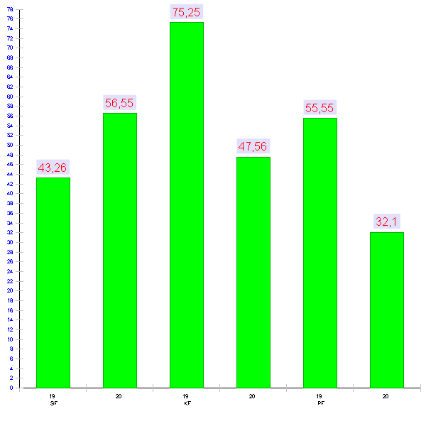

Re: [chart] with multiple categories (on x) [message #911687 is a reply to message #911408] Wed, 12 September 2012 02:04 Go to previous messageGo to next message
the xml tab shows exactly the file that you attached "adjustxaxislabelsmultiline.rptdesign".
I just tried some of the other "view report" options and most of them seem to work!
It works as long as i don't use "View report in web viewer" or preview.
No i see the second line on x-Axis "KF", "PF", "SF" - at last.
Can you please give me some additional advice how to integrate this script? Should i safe beforeDrawAxisLabel function in a text file or as string in java?
And what is the relation between afterDataSetFilled (you said i should add this to java) and beforeDrawAxisLabel?

Re: [chart] with multiple categories (on x) [message #932821 is a reply to message #919079] Thu, 04 October 2012 09:12 Go to previous messageGo to next message
I am back from vacation so better late than never: Thank You!
I tried your code first by simple merging the code with "StandAloneChart" (from an Example-Zip Package). i simply substituted createStackedBar() method with the code you gave: the result:
index.php/fa/11727/0/
As you see the result is not the same. But on first sight the results reflects exactly the script: <weeknumber>+ "\n\r " + <Region>
So Region is in next line (not always) with one space-character before region's name. (since your first answer i asked myself how your script centers the next line)
Since i have to rewrite the script for my special use case this problem is not a real "problem"
but
A second and more eminent problem occurred if i tried to adopt your solution to other examples (more similar to my use case): i substituted "createStackedBar()" with the code given in "Side By Side Bar" example (first example in Birts' Chart Examples view in eclipse). Then i just added the setscript() and copied the data from your example:
index.php/fa/11726/0/
so for some reason the second line is cut off - how to solve this problem?
[Updated on: Thu, 04 October 2012 09:25] by Moderator
Re: [chart] with multiple categories (on x) [message #932986 is a reply to message #932821] Thu, 04 October 2012 12:28 Go to previous messageGo to next message
Did you use these two lines?
xAxisPrimary.getLabel( ).getCaption( ).getFont( ).setSize(6);
xAxisPrimary.setLabelSpan(30);
Jason
Re: [chart] with multiple categories (on x) [message #933689 is a reply to message #932986] Fri, 05 October 2012 04:42 Go to previous messageGo to next message
no -
THX! that solved the problem.
do you have any hints about centering the second line. are there any means to get the center position from a group of bars (in your example 2 bars but in general one group has n bars)?
