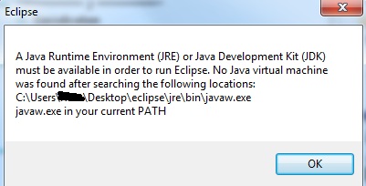

I have a problem with eclipse.
I've download and installed ''jdk-7u7-windows-i586'' and extracted ''eclipse-jee-juno-win32-x86_64''
I want to start coding and I chose the game Runescape as a test subject/first step.
Everytime I try to open eclipse this message pops up ; (see attachment)
Any idea on how to fix it? I've tried creating the path and copied the javaw.exe from my Java directory but another error popped up.
-Thank you in advance.
  • Attachment: 1.jpg
    (Size: 28.03KB, Downloaded 298 times)
[Updated on: Tue, 04 September 2012 21:05] by Moderator

Re: Cannot open Eclipse [Java Path Issue] [message #908281 is a reply to message #908273] Wed, 05 September 2012 00:45 Go to previous messageGo to next message
Roro,
You're asking questions in the middle of the night (in Europe and
certainly after working hours in NA) and expecting answers in less than
3 hours? Did you actually install an appropriate JDK on your machine?
In any case, copying just the *.exe isn't sufficicient because that exe
isn't going to find the libraries it needs. You should use the -vm
argument (which you can also put in the eclipse.ini so you don't have to
keep specifying it) to point at where the exe actually is.

Re: Cannot open Eclipse [Java Path Issue] [message #908298 is a reply to message #908289] Wed, 05 September 2012 01:28 Go to previous messageGo to next message
When you get a JDK from Oracle, you install it. It sets things up in
(at least on my machine):
c:/Windows/System32
You can try java.exe -version there to see which one is there. That's
the one used by default. If it's not the right one, it's not going to work.
An alternative to specifying the -vm arguments (what exactly did you
try?) is to copy the jre folder to the folder that contains your
eclipse.exe. If you want the JDK source, be sure to copy the JDK's
src.zip into that jre folder too.

Re: Cannot open Eclipse [Java Path Issue] [message #908804 is a reply to message #908798] Wed, 05 September 2012 23:07 Go to previous messageGo to next message
Found te reason. 64bit OS ,64 bit eclipse ,32bi jdk.
Re: Cannot open Eclipse [Java Path Issue] [message #908831 is a reply to message #908804] Thu, 06 September 2012 00:44 Go to previous messageGo to next message
mathew rajan wrote on Wed, 05 September 2012 23:07
Oh god...thank you so much.
I can't believe I fell for this.
I actually believed I downloaded the 64bit, but it seems not.

Re: Cannot open Eclipse [Java Path Issue] [message #908838 is a reply to message #908831] Thu, 06 September 2012 01:00 Go to previous message
Is your Eclipse 64 bit?
On 06/09/2012 6:44 AM, roro bond wrote:
> oracle(dot)com/technetwork/java/javase/downloads/jdk7u7-downloads-1836413.html
> I downloaded the one of Windows x86 which is 64bit.
> And my Windows is 64bit.
