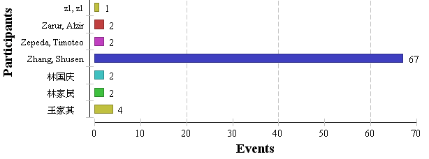

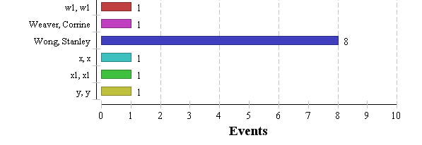

I created a bar chart with flip axis. The x-axis will display about 100 categories, so I split the bar chart onto multiple pages by putting the bar chart in a table group and made the chart display 30 categories per page, this works properly.
Now, the issue is the max y-axis values on the pages are different.
For the y-axis, I tried to use JavaScript to set the y-scale to the max value. This did not solve the issue. Now, I have added a computed column for max y-axis value in dataset, and I hope I can set the max y-scale value with it, but I don't know how to get it in bar chart. Could anybody help me?
Thanks advance.
index.php/fa/11325/0/
index.php/fa/11326/0/

Re: Max y-axis value on split bar chart [message #906092 is a reply to message #905178] Fri, 31 August 2012 11:49 Go to previous messageGo to next message
Thanks Jason,
I tried the example you provided, unfortunately, it cannot solve the issue. I think I should give more detail description:
1. adding dataSet column [matTotal]to the table header (the bar chart in the table)
2. onRender:
reportContext.setGlobalVariable("maxscale",this.getValue());
(this is good, I get maxscale is 67, for example)
3. beforeGeneration:
yscale.setMax( NumberDataElementImpl.create(icsc.getExternalContext().getScriptable().getGlobalVariable("maxscale")) );
(the issue is here, the max scale value is not always 67 on each page, it dynamically changes depend on the maxscale for that page, see the attachments above).
So, how can I let all pages keep same max scale value(i.e. 67)?
Shusen
