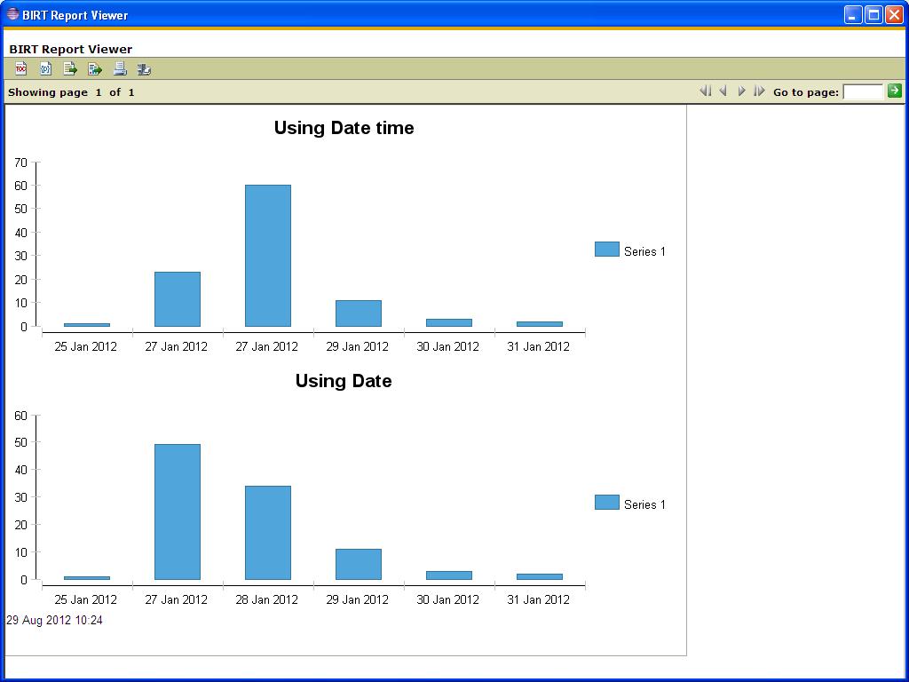

Hi Jason,
The print screen was taken of charts using 2 datasources based on identical data and set up, with the only difference being I changed the output column type to from date time to date.
I have also uploaded an excel file of the results shown in Preview results for each (thery are in random order but are the same data points).
Thanks for your help,
James

Re: Problem charting datetime [message #905042 is a reply to message #904859] Wed, 29 August 2012 11:29 Go to previous messageGo to next message
James
I am trying to recreate the issue, but it does not look like the dates
are the same in the xls sheet. BTW do you have aggregration on the
x-axis disabled? Is the x-axis type set to date time? What are you
using for the y-axis values?
Jason

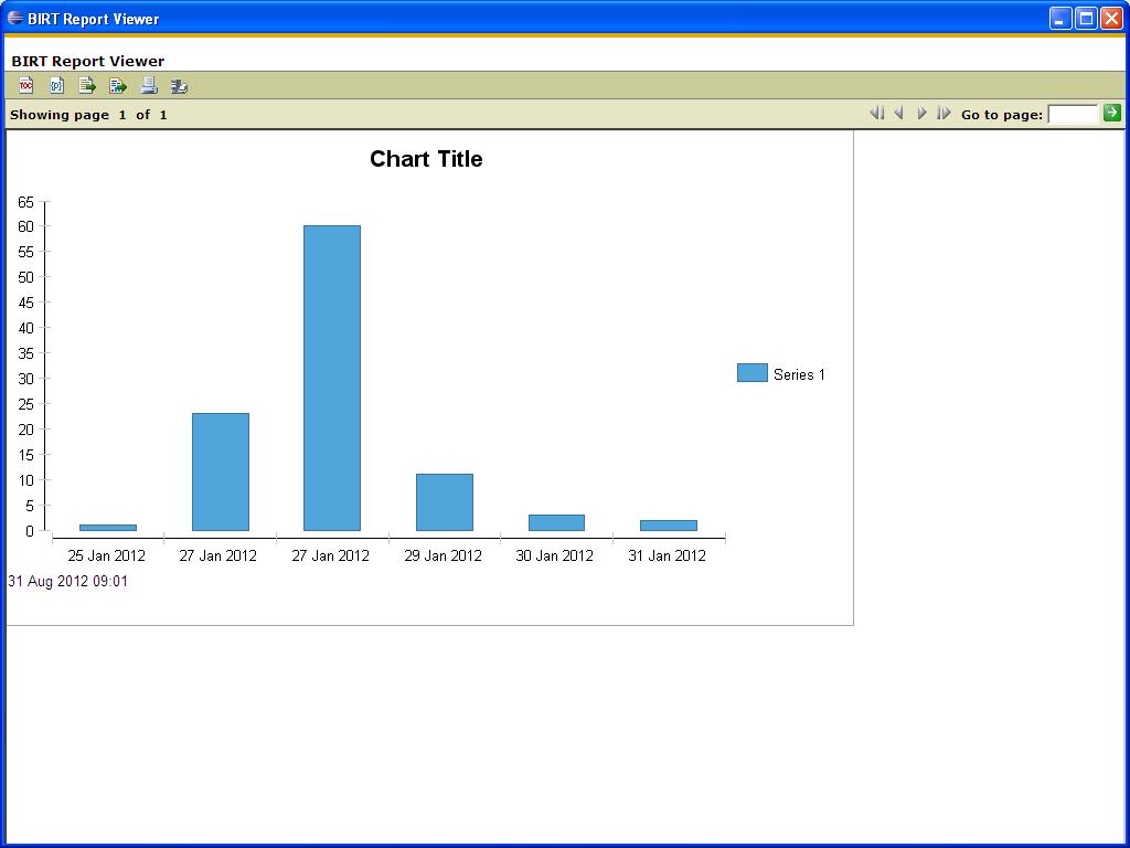

It still happens when I use the .csv datetime column(see attched) but not when I use the date column (the same as what happens with my oda). So this seems to suggest it isn't a preoblem with my oda.
What in BIRT could be causing this?
James

Re: Problem charting datetime [message #905935 is a reply to message #905861] Fri, 31 August 2012 06:35 Go to previous messageGo to next message
I just tried this with a fresh install of eclipse and BIRT and still have the same problem..
