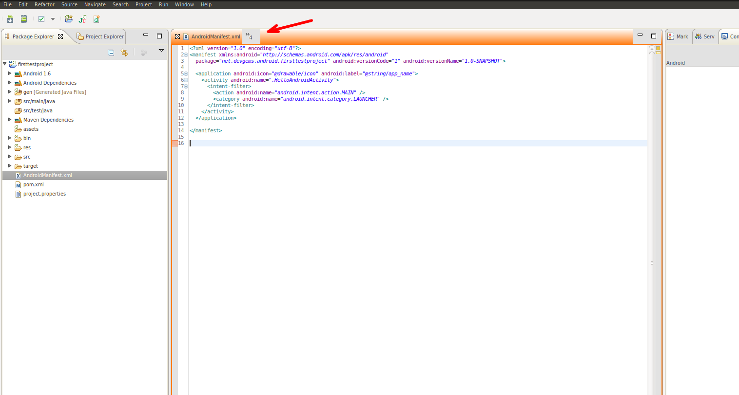

Could anybody tell me how to get rid of this annoying setting of the code editor which suddenly shows only one file, although there is enough space for displaying all files. I didn't find any setting yet. Please see the screenshot.

I already found the solution. Due to another problem with blue tabs I installed the E4 css editor. There is this setting.
#org-eclipse-ui-editorss CTabFolder.MPartStack {
    swt-single: true;
When I set it to false, it works.
