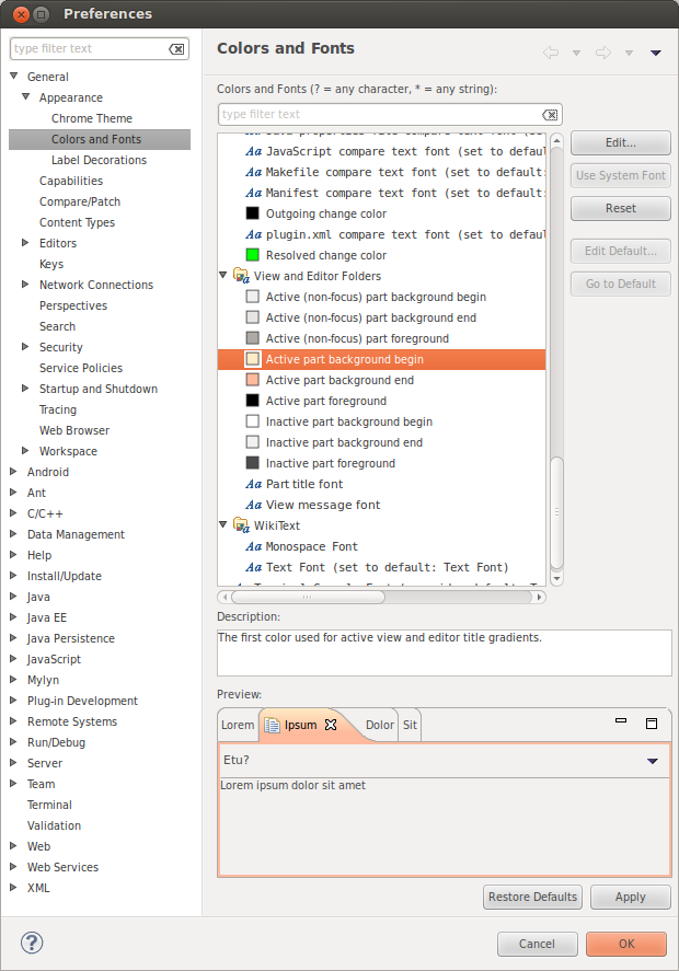

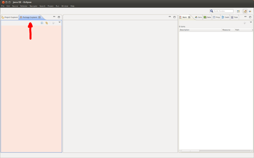

I reconfigured Eclipse Juno to use the classic theme look. What I can't get managed is the tab color of all tabs. They are blue and this causes eye cancer to me. I couldn't find any setting to solve that. In earlier versions I had success with changing colors of list items, not configurable by Eclipse itself, while using an ".eclipse-gtkrc":
style "eclipse" {
        font_name = "Sans Condensed 8"
style "listitem"  {
        base[ACTIVE] = "#AAAAAA"
class "GtkWidget" style "eclipse"
class "GtkTreeView" style "listitem"
And invoked it like this:
#!/bin/bash
env GTK2_RC_FILES=/usr/share/themes/Ambiance/gtk-2.0/gtkrc:/home/markus/.gtkrc-eclipse '/opt/eclipse/eclipse'
I tried to solve this tab color problem in the same way, but I don't know which GTK component this is. I thought it is GtkNotebook, but changing colors of this widget has no effect.
Any ideas how to change the tab colors, maybe in a different way?
By the way: There are settings to change the colors (see tabcolor_juno.png), but these settings don't cause any effect, so can I assumed it is a bug?
