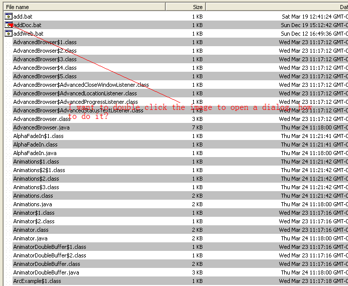

hi all,
how to add doubleClick event listener to the image in the cell of the tableviewer?
I want to double click the image in the image below and open a dialog.
index.php/fa/11172/0/
David
Re: how to add doubleClick event listener to the image in the cell of the tableviewer? [message #901674 is a reply to message #901669] Tue, 14 August 2012 01:24 Go to previous messageGo to next message
add mouse listener to the Table and check the event coordinates against
TableItem#getImageBounds.
HTH,
Ivan
On 8/14/2012 7:16 AM, Song David wrote:
> hi all,
> Thanks
> David
Ivan Furnadjiev
Twitter: @EclipseRAP
Re: how to add doubleClick event listener to the image in the cell of the tableviewer? [message #901693 is a reply to message #901674] Tue, 14 August 2012 03:50 Go to previous message
Thanks Ivan, it just does work.
