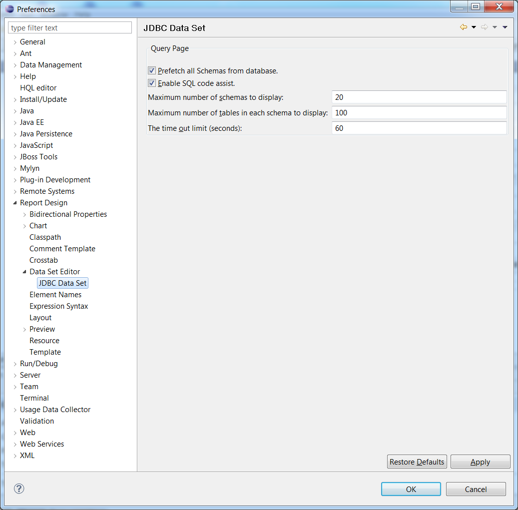

In sql developer I am seeing all the data tables and functions but when looking through my datasource in birt i am only seeing half of schemas and tables? I have the filter set to show all. How can I view/get access to all my data schemas/tables. Thanks

You can set the number of schemas displayed in the preferences. See
attached image.
Jason
