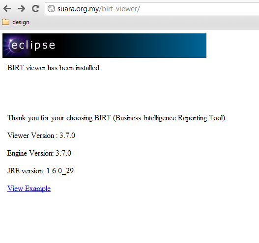

during my development and deployment on ourself server,everything was ok..
but when we try to deploy it on hosting server (3rd party server),problem happened..
i can browse birt-viewer homepage (see attach file)..

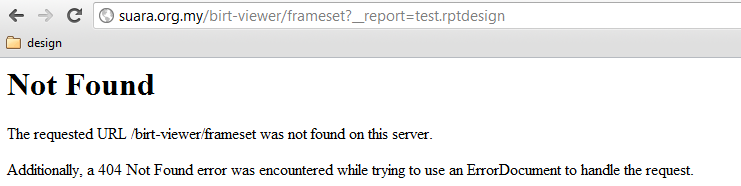

but when i click on view example..404 error appear (refer attach file).
my hosting server seems not recognize the frameset path.
our hosting server run on Apache Tomcat/5.5.35,i'm using birt runtime 3.7.
i have change frameset to run,preview,or output,but stil can't load even test.rptdesign
any clue to resolve it?..thanks in advanced

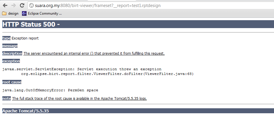

however,after i try to reopen birt eclipse home page,
browser return me an error
java.servlet.ServletException. (see attachment)
java.lang.OutOfMemoryError : PermGen space
please advised me..since my birt reporting deploy on 3rd party hosting,
i'm not being able to debug direct to tomcat configuration.
thanks in advanced
Re: can't load birt-viewer on hosting,frameset was not recognized [message #899152 is a reply to message #898963] Mon, 30 July 2012 12:51 Go to previous message
Are you allowed to modify your tomcat jvm parameters? This error can be
fixed by adding JVM parameter. I do this in my catalina.bat file
set JAVA_OPTS=%JAVA_OPTS% -XX:MaxPermSize=256m
Jason
