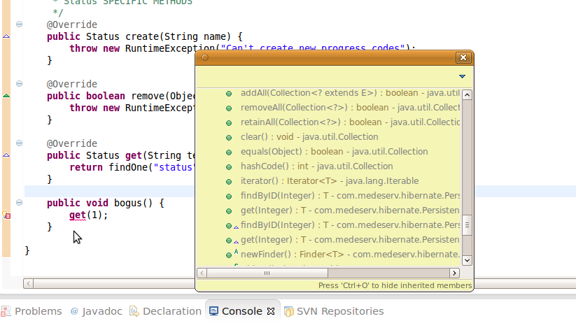

Definitely seeing extra elements in the outline view when looking at the source file. See the attached screenshot - you can see the red squiggly on the get(Integer) method call, alongside the outline view showing that method as being defined in a superclass. So it's pretty clear that the structure model is not consistent with the AST that's driving the compile error markings. Still, it's the compile errors that are the main problem so I mention that only in case it's of interest to you as perhaps representing an issue in the tooling.
