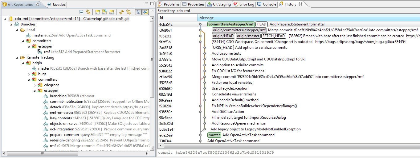

Here a proof from one of my workspaces:<br>
<br>
<img src="http://www.eclipse.org/forums/index.php?t=getfile&amp;id=10767" alt=""><br>
<br>
I would expect to see exactly one outgoing commit, given the
committers/estepper/rmf branch is checked out because the local
branch is one commit ahead of the remote tracking branch. Am I
misunderstanding something?<br>

I notice that the nasty NNTP bridge has removed the screenshot I had embedded (and left all the HTML markup). That
mayhave made it difficult or impossible to see my exact situation. But I start to see what you're saying. Let me
explain/ask again:
I've created a local branch "committers/estepper/rmf" from local master and checked it out. I *thought* that it, by
naming convention (better: pattern configuration aka fetch ref spec?), tracks its remote tracking branch that properly
gets created during the first push. But indeed it seems that it still tracks my local master branch, which would explain
my confusion about the decoration.
So my question should be: What is the simplest way to create a new remote branch, together with a respective remote
tracking branch and a local branch to checkout and work with? I think that would be more or less the same thing as a
normal new branch in CVS or SVN, which I can create with a single and obvious mouse click there.

Tracking doesn't use name patterns. A branch tracks another branch or reference iff you explicitly configure it to do so. Usually this is done at branch creation, either with the "--track" option in Git or by selecting the Rebase or Merge radio button in the EGit "Create Branch" dialog. You can also do it after the fact by setting repository configuration values.
As for creating a new remote branch and tracking it, this is a known issue is EGit/JGit. In command line Git, the creation of a new remote branch from a local branch automatically configures the local branch to track the corresponding remote reference. JGit doesn't do this. To configure tracking in this case you must either delete and recreate the local branch with the right options in the Create Branch dialog, or you must add configuration values for branch.<local-branch>.remote and branch.<local-branch>.merge where <local-branch> is the name of your local branch. You might also need to adjust remote.<remote-name>.push. where <remote-name> is the name of the remote (typically 'origin'). If you want pull to use rebase rather than merge, that's yet another config setting.
As you can see, the simplest option is to use command-line Git to create the new remote branch. It does everything for you. If you want to use EGit, the simpler choice is to delete the local branch, then recreate it from the remote reference, selecting either Merge or Rebase in the Create Branch dialog. Setting the configuration directly isn't difficult but it's certainly the least simple option.
