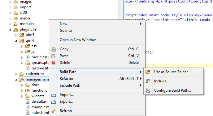

what is the difference between this two menu items in PHP Explorer Context Menu?
On the picture in attachment is location of the menu items.
Thank you

Hi sNop,
I'm not sure what's the question since you're not a newbie...
PHP Project has a source folder to build. It is same as the project folder by default and it can be customized at Preferences > PHP > New Project Layout.
'Use as Source Folder' changes it on the fly.(this action adjusts inclusion/exclusion pattern also)
'Include' simply adds selected folder to build path.
'Exclude' simply removes selected folder from build path.
Include/Exclude are convenient actions for modifying build path(inclusion/exclusion pattern). See Configure Build Path(or Project Properties) > PHP Build Path.
This is a feature of DLTK and it had been introduced in pdt 2.0.

Oh, I didn't guess so because of buildpath2.jpg Cool

On 10. 7. 2012 2:02, Toshihiro Izumi wrote:
> Hi sNop,
sry, I didn't study the difference, I simply ask here :), was lazy
Exactly what i want to know, thank you
The menu item 'Use as Source Folder' confused me, I absolutely understand how build path works.
