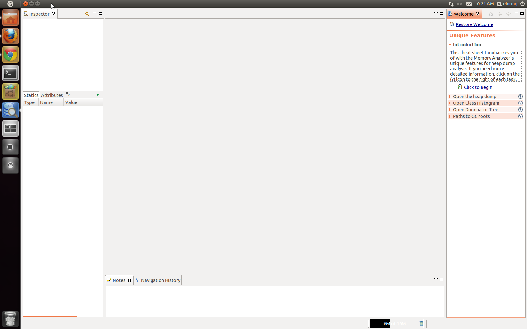

I found a fix, of sorts. The problem is with Ubuntu's Global Menu (part of the Unity UI). The menu bar for any window is at the top, rather than with the window itself. It's hidden by defauult; you see the options when you hover over the bar. I've attached a screenshot showing how the options do not appear for MAT.
By disabling the global menu, I see the options again.
This is more of a workaround than anything though. A fix should be made so the options appear even if you are using the global menu bar.

  • Attachment: mat_menu.png

Not using Eclipse right now and there are no plans to install it, so I can't say. Sorry! As I said above, it appears that the problem is just with Unity's global menu. After disabling it, the menu options are visible again. Ubuntu 11.10 may exhibit the same issue as it also uses the global menu. I'm not sure about Ubuntu 12.04. Sorry i can't be of more help!
