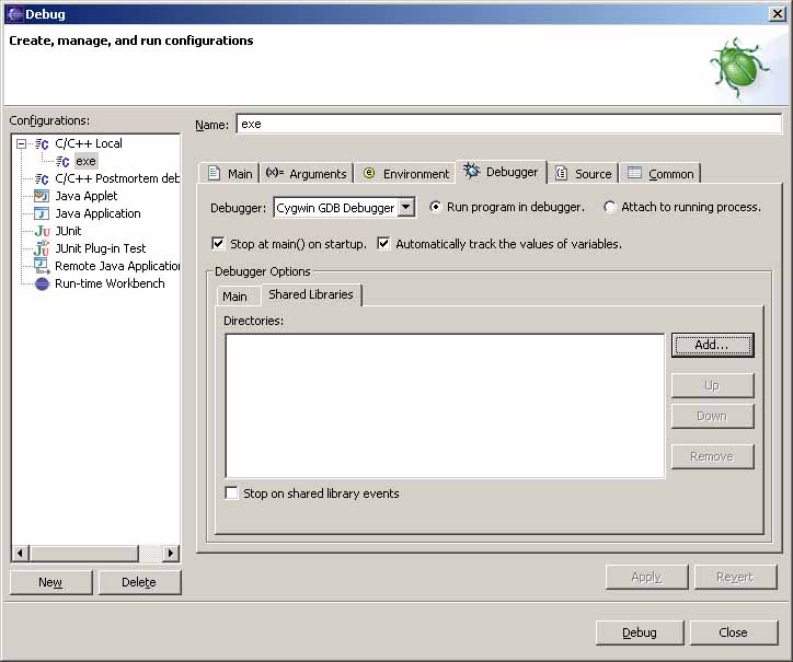

Ooops - I just tried going back in and adding Shared Libraries to the
debug configuration. Now I get an error "CDT can't debug" or something
like that. Good grief.

Re: Debugging Shared Libraries [message #116942 is a reply to message #116757] Tue, 24 August 2004 11:29 Go to previous messageGo to next message
David,
I do not have anywhere near as much trouble as you are reporting.
Granted, I am using a simple example right now, but I build a DLL as a
standard project, link it into a managed C++ project, and I can step
into the DLL no trouble. Why don't we start with the simple case first,
then work out from there.
I use the latest stuff I downloaded from Cygwin:
kernel: 1.5.10
/usr/bin/g[cc|++]: 3.3.3
/usr/bin/gdb: 2003-09-20-cvs
I build the DLL source with the following arguments:
g++ -O -g -DMAKEDLL -Wall -c -fmessage-length=0 -o $@ $<
and the DLL/export lib with:
g++ -shared -Wl,--out-implib=libmsgs.dll.a -Wl,--output-def=msgs.def -o
The main project includes the right header from the DLL project and gets
built with USEDLL defined (the header has the following in it)
#if defined(MAKEDLL)
# define DLLEXPORT __declspec(dllexport)
#elif defined(USEDLL)
# define DLLEXPORT __declspec(dllimport)
#else
# define DLLEXPORT
#endif
It links in the library that is built (lib<name>.dll.a) and after the
build I copy the cyg<name>.dll into the directory where the EXE is located.
From there, the only grief I get is when I try to step into methods in
the system libraries (like trying to step into a call on basic_string).
I realize that you are frustrated and you had hoped to find a commercial
quality IDE, but before you give up all hope, let's at least eliminate
the possiblity that some of your problems are relted to how the project
is being built (or a missing intermediate step).
Sean

Adam,
When I bring up the debugger/shared library tab, I don't see the option your
talking about (I've attached a screen shot, for clarification)
-- Dave

Re: Debugging Shared Libraries [message #117113 is a reply to message #117024] Tue, 24 August 2004 20:38 Go to previous messageGo to next message
Originally posted by: adam.n.gordon.saic.com
That's b/c you are using the Cygwin GDB Debugger. Dunno if using the
straightup GDB debugger will work, but that's where the checkbox is.
-Adam

Re: Debugging Shared Libraries [message #117177 is a reply to message #117113] Wed, 25 August 2004 09:22 Go to previous messageGo to next message
"Adam Gordon" <adam.n.gordon@saic.com> wrote in message
news:cggmss$a34$1@eclipse.org...
> -Adam
Ah! OK - I switched over the the straightup gdb debugger, flipped the
switch on automatic loading of DLLs and it avoids the infinite "run in the
background/waiting" message box. Thanks for the tip.

2) Then, be sure you're using the "straight up gdb" debugger, instead of the
Cygwin gdb debugger
3) Go to the Debug/Debugger/Shared Libraries tab and make sure you select
the option to automatically load shared libraries.
This combination of steps seemed to do the trick for me.
-- Dave
