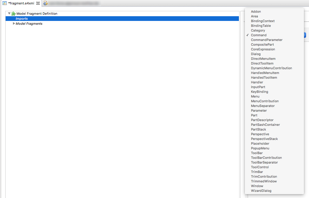

Could you import shared elements?
Re: Adding 3.x ViewParts to E4XMI [message #1732208 is a reply to message #1732205] Fri, 13 May 2016 08:56 Go to previous messageGo to next message
Dirk Fauth wrote on Fri, 13 May 2016 12:28
I don't know. The model editor in Neon does not give me an option in the drop-down to import a shared element.
Importing a "Part" does not work. There are none and/or the ones created by the compatibility layer are not visible to the model editor. I'm also not sure if the compatibility layer uses stable xmi ids that would work as stable references.
