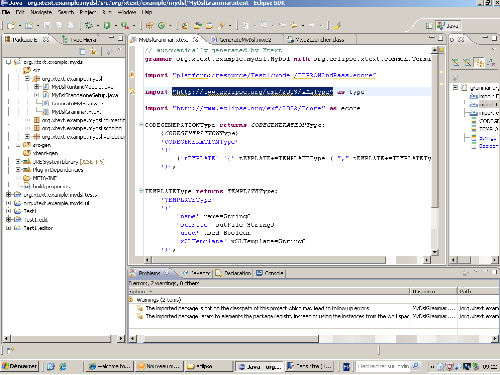

i'm a beginner with Xtext and using eclipse-SDK-3.7.1-Xtext-2.2.1-win32
i'have problem when i'm generating Xtext grammar from an Ecore model , in fact i've succeed to generate the grammar but the grammar generated has 2 warnings and i don"t know how to fixed them.
the problem i have is with the 2 first imported files:
the first imported file : give me this warning " The imported package is not on the classpath of this project which may lead to follow up errors."
The second imported file give me this warning "[/quote] The imported package refers to elements the package registry instead of using the instances from the workspace".
can somebody help me to fix this.
  • Attachment: Test1.png
    (Size: 138.16KB, Downloaded 208 times)
Re: generation of an Xtext grammar [message #871554 is a reply to message #871552] Mon, 14 May 2012 08:02 Go to previous messageGo to next message
i' can't put the code i' dont know why i have an error when i put the code , but you can see the picture and you will see the 2 warnings i'm talking about.
thks

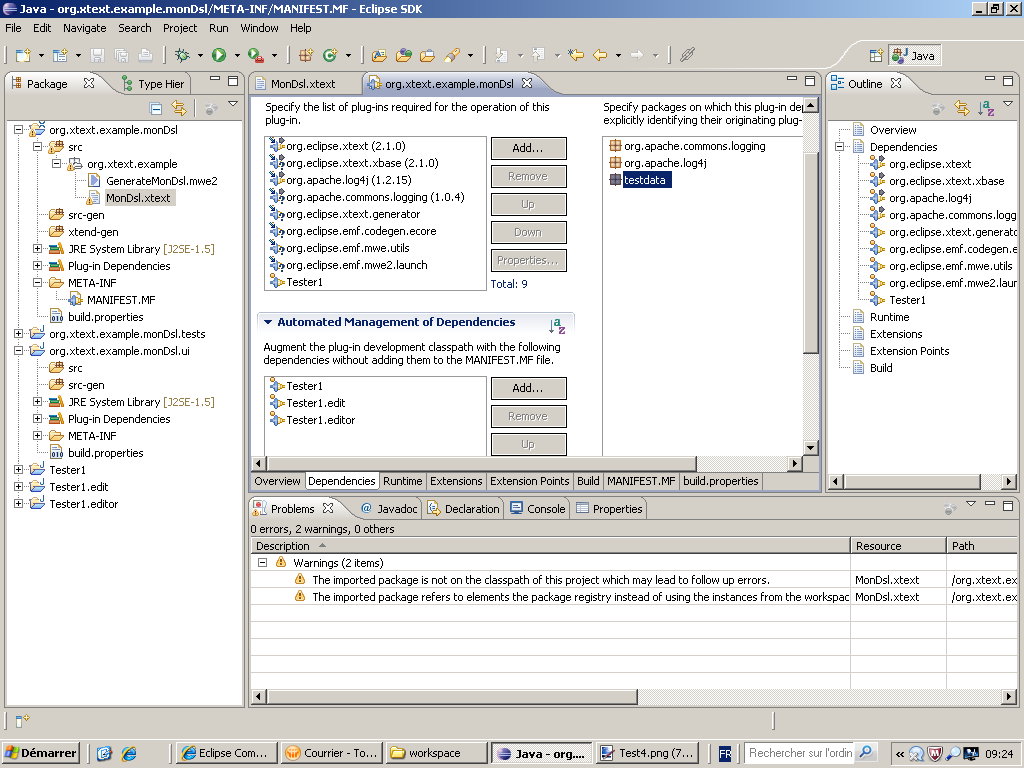

Re: generation of an Xtext grammar [message #871945 is a reply to message #871625] Tue, 15 May 2012 03:38 Go to previous messageGo to next message
Hi Holger
i did as you said but nothing change , i still have the same warning .
i've tried to add Tester1 in the dependency panel as you see in the picture , it appears as a plugin and not a package , hope is a right way to do it , i just add it as a plugin because there was not such a package called Tester1 among the possible importable package
  • Attachment: Test5.png
    (Size: 89.46KB, Downloaded 200 times)
  • Attachment: Test4.png
    (Size: 84.01KB, Downloaded 186 times)
Re: generation of an Xtext grammar [message #871973 is a reply to message #871945] Tue, 15 May 2012 04:25 Go to previous messageGo to next message
Am 15.05.12 09:38, schrieb frank fotso:
> Hi Holger

the MANIFEST.MF looks correct:
 org.eclipse.xtext;bundle-version="2.1.0";
       org.eclipse.xtext.xbase;bundle-version="2.1.0";
       org.apache.log4j;bundle-version="1.2.1";
       org.apache.commons.logging;bundle-version="1.0.4";
       org.eclipse.xtext.generator;
       org.eclipse.emf.codegen.ecore;
       org.eclipse.emf.mwe.utils;
       org.eclipse.emf.mwe2.launch;
       Tester1;bundle-version="1.0.0";

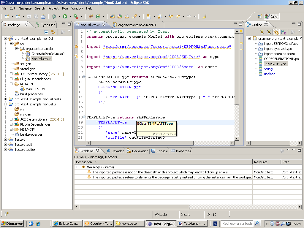

Two things.
Test1 need Xtext nature. Rightclick on project->configure->add XtextNature
Then you have to refere to your EPackage with the NsUri ->
import "file:/D:/frank/workspace/EEPROM_2nd_pass.xsd"
BTW: Change that to something else like http://www.eeprom.com/1.0 etc.
Need professional support for Eclipse Modeling?
Go visit: http://xtext.itemis.com
Re: generation of an Xtext grammar [message #872151 is a reply to message #872148] Tue, 15 May 2012 10:49 Go to previous messageGo to next message
oki thks
one of the warning has dissapear , it remains one known as : " The imported package refers to elements the package registry instead of using the instances from the workspace " .
how can i fix that one
Re: generation of an Xtext grammar [message #872176 is a reply to message #872151] Tue, 15 May 2012 11:35 Go to previous messageGo to next message
The problem is that that the EPackage
http://www.eclipse.org/emf/2003/XMLType references
"http://www.eclipse.org/emf/2002/Ecore" transitive so that you have
"http://www.eclipse.org/emf/2002/Ecore" twice in the scope. Therefore
this warning appears but can be ignored. I agree that the message is not
very helpful so feel free to file a bug.
