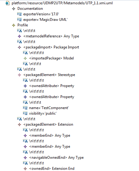

In order to try to load the model with the UML Model Editor as you suggested, I have changed the extension xmi to uml, and I could load it, but it is not what I expected, I mean: this is not being recognized as a UML Profile (see the attached img)
I can imagine that there is a problem with the definition of the xmi. According with its content, it seems to have been generated with MagicDraw. Do you know if there is any particular issue about the xmi generated with this tool.
What would you suggest me in order to work with the UML Testing Profile?
1.- use the standard implementation provided by OMG
2.- develop the profile from the scratch, with the UML 2 Tools or Papyrus
3.- ???
Thank you for your quickly response!

*.uml is only for UML using an Eclipse MDT/UML2 namespace.
*.xmi can be for OMG namespaces.
//http://www.////omg/./org///spec///UML///20090901// is the OMG UML 2.3
namespace which is not supported by Indigo.
Juno introduces UML 2.4 and 2.4.1 support and consequently many more
namespaces but not UML 2.3.
(https://bugs.eclipse.org/bugs/show_bug.cgi?id=378281 raised.)
Try editing the XMI to use http://schema.omg.org/spec/UML/2.2.
Ed Willink

As I wrote; UML 2.3 is not supported so you need to use either UML 2.2.1
with Indiigo or UML 2.4 with Juno.
To change UML versions you can edit the XMI file to change
http://www.omg.org/spec/UML/20090901 to
http://schema.omg.org/spec/UML/2.2 and it might work, provided the XMI
doesn't actually use any UML 2.3 facilities.
Ed Willink

Edward, now it is working!! thank you!
My problem was that in a previus try I changed the extension from xmi to uml, but as you said these namespaces are for omg standard, so the file must be an xmi, right?
thank you again!
