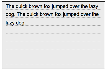

Hi Jason
Not really using anything just now. Tried a series of different options but couldn't see any obvious solution with any of them. I started with a a data item though, yes.
To be explicit, I've attached an image mockup of the kind of thing I'm trying to achieve. It shows faint grey dashed lines, not right to the edges, but if it can only be solid black lines right across, that's OK as a compromise.
Brad

There may be a better way to do this but you could use a background
image of lined paper on a grid cell and put your data item in the grid
cell. Look at the middle column in the attached example. Look at the
advanced properties for the cell, under background. Put the image in
the images directory. Another option would be to use two data items,
one with underline text style that would contain your string. Use the
second one to display empty lines. The example does not have it but you
could then script the second one to contain string with ___ for the
number of characters remaining. If you do this remember to put spaces
in so the word wrap will happen.
Jason

Hi Jason
Thanks and yikes. I was hoping not to have to go this route, but I appreciate your confirmation.
Similar to what you suggested, my next preferred approach was to produce an image 1 px high, which is simply a line (or dotted). Then set this as background and set the Y Repeat spacing to '1 ex' - ie the font's height. This was a no-go however, when I realised that Y-repeat spacing isn't configurable.
So I settled on a single line, with fixed white above it. When repeated this gave consistent lines down the box. It was then a matter of setting the Text: Line Height to fixed mm value that lined up properly with the background (a lot of trial and error).
FWIW I've attached the png I ended up with - a grey dotted line. My line height was 5.6mm.
Brad

I actually found in the end that Adobe Reader wasn't coping with the X and Y repeating - it was really slow to render onscreen during scrolling.
I ended up making the line image much wider so repeat mode could be just 'Repeat Y'. New image attached for posterity
