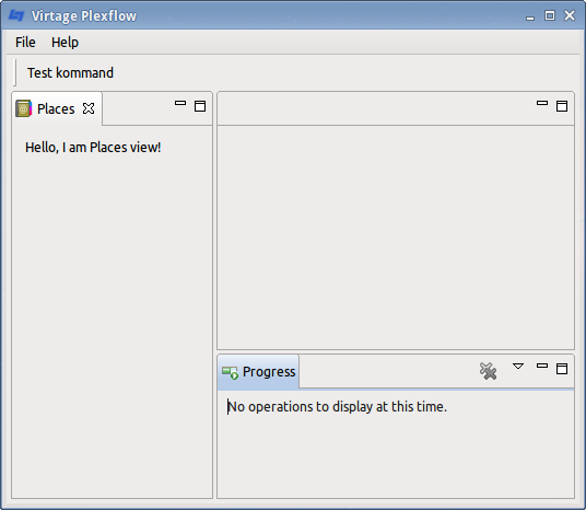

I would like to achieve this layout:

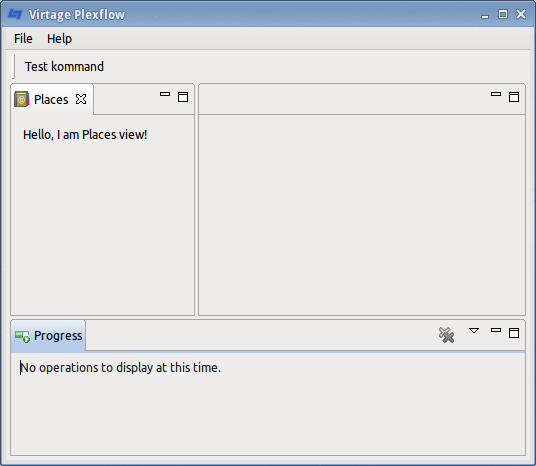

But I am getting:

Please, how to define <perspectiveExtensions> and <view> to create what is figured on second image?
