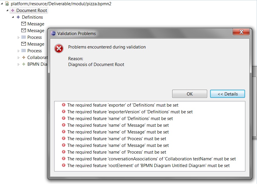

I'm constantly getting some strange errors from the validator at runtime when creating a bpmn2 model. Even with the official example from omg the validator reports similar errors (please see in the attachment). Especially the error "the required feature 'conversationAssociations' of Collaboration testName must be set" is not very elucidating. I also admit that it is not clear to me what is missing there.
The strange thing is, I get these errors with *every* bpmn2 model I open in Eclipse. But not immediately, just when I validate the model by hand (right click on the root element in the Bpmn2 Editor > Validate). And even if I don't validate them, these errors cause other exceptions to be thrown, because I'm working with three languages which depend on each other. So, simply forgetting about the error does not work for me Smile

thanks for pointing this out. There are some differences between the various exchange formats of the BPMN 2 specification. So far, we have used the more (too) restrictive one.
I have now loosened the settings to match the format that requires less attributes. More info at https://bugs.eclipse.org/bugs/show_bug.cgi?id=373502 and https://bugs.eclipse.org/bugs/show_bug.cgi?id=373519
You should be able to update to the latest version by using the update site https://hudson.eclipse.org/hudson/job/bpmn2-nightly/ws/org.eclipse.bpmn2.site/target/site/ (enter this URL @ Help->Install new software).
BTW: what was (wrongly) declared as missing before was a child of type ConversationAssociation for the Collaboration element (a right-click on the Collaboration element offers you the option to create one).
