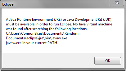

So, I was playing around with a text-based game I had recently coded and tried to get it to run through command prompt; being unsuccessful I dug deeper into the problem and for some reason, realized 'javac' was missing. So I un-installed Java and the JDK and reinstalled them, this time deciding to go ahead and install the JDK version bundled with Netbeans to try out the drag and drop swing builder (Random information that may be useful).
The problem is that, during my escapades of fixing Java, there was an error during compiling so I went back into eclipse to figure out the error in the code. Upon clicking Eclipse I received this error; and after spending an hour trying to fix it myself and not coming out successful I figured I'd post here.
Update: I tried fixing it with -vm Path in the eclipse.ini but that didn't work. It gave some long winded error message, and I tried several more different paths that I thought may work and again failing. I also reinstalled it, which as I had predicted, did not fix the problem.
- End of Quote from other forum.
Also, the errors that have occurred are all here already posted on the thread on the other forum (Darn, can't post links yet, I'll post it when I can, see below for first error) If I need to put them on here I can do that as well.
Please help!
Connor.

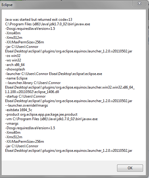

That is the problem, I went through that Wiki page the first time. And it did not work. Here I'll post the errors and what I put accordingly.
Try One:
-vm
C:\Program Files (x86)\Java\jdk1.7.0_02\bin\javaw.exe
Error: ErrorResponceI

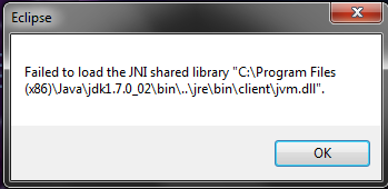

Try Two:
-vm
Error: ErrorResponce2

Thanks for the help but I found the error. It was a problem with the CPU Architecture of the JDK.
Connor!
> Thanks,
> Connor!
Yup, matching bittedness of the JDK and Eclipse is always the next
question. I could have diagnosed that with the (full) contents of
eclipse.ini.
Best of luck.
