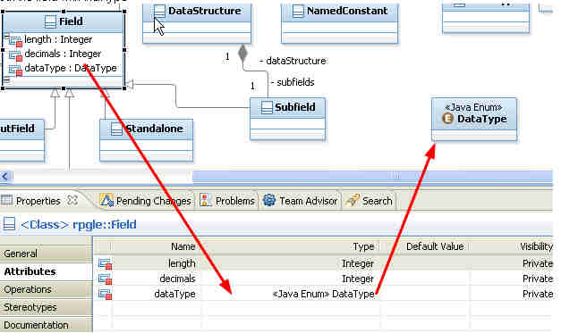

1) enum
Now that Java 5 has been around for a while, can EMF generate the native Java enum for enum attributes?
I am using Rational Software Model now to create the class diagrams, how do I go about specifying that I want to use an enum for a particular attribute. I can't find the stereotype to make it work. Is there some features I need to install/configure?
I have researched on the internet and applied the ePackage stereotype but I still can't find the EMF <<enum>> stereotype. Can you tell me what modelling idiom to use to get this simple result?

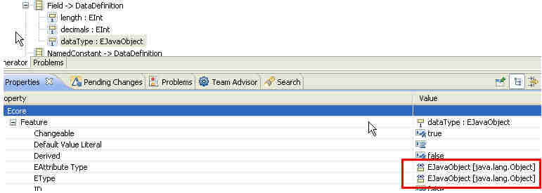

If I use the Java enum, the EMF reload sees it as a java.lang.Object.
(see screen shots)

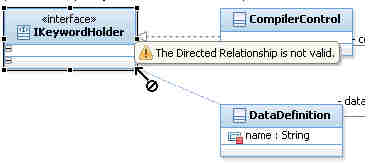

2) How do I specify that a Class should implement an Interface. If I use the UML Interface
index.php/fa/6853/0/
A generalization relationship is not allowed and the realization relationship doesn't generate anything in the model .java.

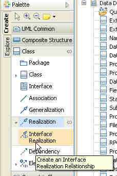

Good news, for Interface extension, all you have to do is switch the type of Realization to Interface Realization and then it works.
Ed, your tip about working backwards helped me know what to look for.
When an ecore.genmodel exports, it exports to a .uml file which is not the same as the .emx file I am starting with, but it at least gave me a clue.
Re: How to specify enum as attributes using Rational Software Modeler [message #782941 is a reply to message #782933] Tue, 24 January 2012 14:26 Go to previous messageGo to next message
index.php/fa/6860/0/
As you can see, the trick is switching the palette item to "Interface Realization"

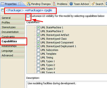

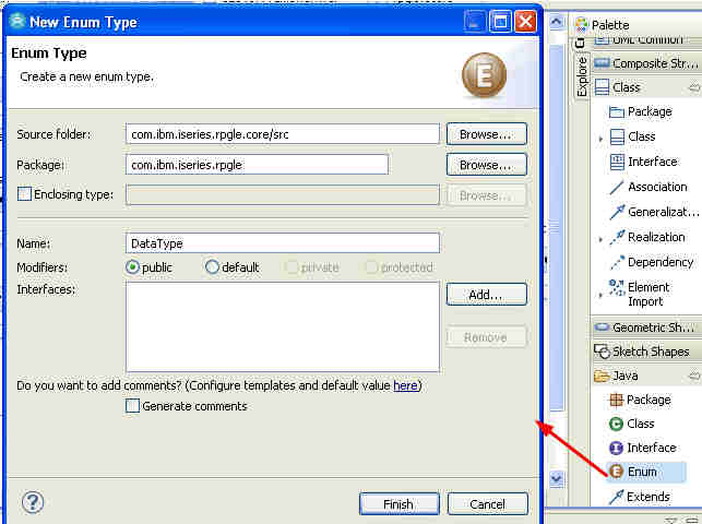

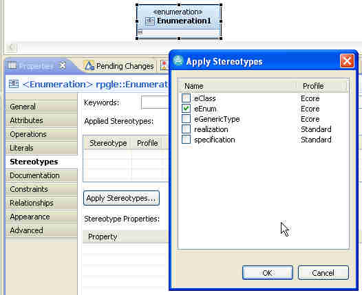

But there was one more wrinkle. The <<eenum>> stereotypes only apply to UML Enumerations, and none were visible on my palette, even after digging under the divoted Class icon.
But they were visible on the models I imported via Ed and Ed's advice. The problem was that by default on the package's properties, under the Capabilities tab, some of the UI elements were filtered out.
See
index.php/fa/6863/0/
By unchecking this filter, the Enumeration became visible on the palette and the eenum stereotypes could be applied.
index.php/fa/6864/0/

> But there was one more wrinkle. The<<eenum>> stereotypes only apply to UML Enumerations, and none were visible on my palette, even after digging under the divoted Class icon.
> See
> Thanks again for all your help.
