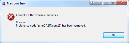

Thanks for your answer.
I've tried to log with ssh+git or git+ssh but I have theses errors :
index.php/fa/6717/0/
OR :
I precise that I'm able to clone / pull / push from Git Bash on my workstation.
Matthew, could you provide me a screenshot of your config when you're cloning a repo from EGit please ?
[Updated on: Wed, 11 January 2012 11:33] by Moderator
Re: Egit + Gitolite [message #778209 is a reply to message #778203] Wed, 11 January 2012 11:45 Go to previous message
OK issue solved, this is because Eclipse use /ssh folder instead of .ssh folder. Thanks
