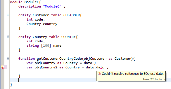

What i trying to get now, is, avoid a warning error :
http://img201.imageshack.us/img201/4230/pngmu.png
How you can see, my grammar allows to declare in codeblocks (pseudocode) :
var NAME as [Entity] = Expression
So, when i :
NAME. //-> In the scope I get all the features of the Entity in the cross reference.
But, my grammar allows too to declare variables without a defined type.
So is correct to said :
variable = data.data
And if "data" is a variable with type, I get the features of the entity but if "data" is a abstract variable, I want to allow everything. I.E.
function CalcPrice(){
variable = something.something // I get error because something.something is not a EObject
So, where I can avoid this error?, Validation? ScopeProvider?
The compiler is already done, so i dont need to know wich object is in the variable.variable,this is especific for a variable content assist.
Thanks, in advance.

> Maybe the rule names are incorrect, but this is my sample grammar so dont worry about that.
> So, when i :
> Thanks, in advance.
