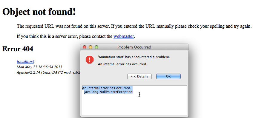

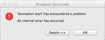

Hi I have arrived to this forum googling "Eclipse Animation Start problems" and I really home I can get your advice. I have installed Eclipse on my Mac following the instructions of a book : PHP for Absolute Beginners that explains you right away what I am : an absolute beginner ... Smile Be patient with me!!!
My problem is the software seems not to work properly giving me the following alert:
"Animation start" has encountered a problem. An internal error has occurred.
Details:
An internal error has occurred. Java.lang.NullPointerException.
As a result nothing runs on the browser when it test to the local url created through xampp.
In attachment you can see some screenshots of what I mean. Can you kindly help?

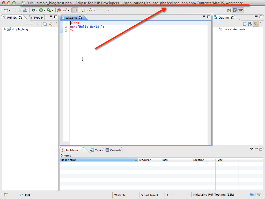

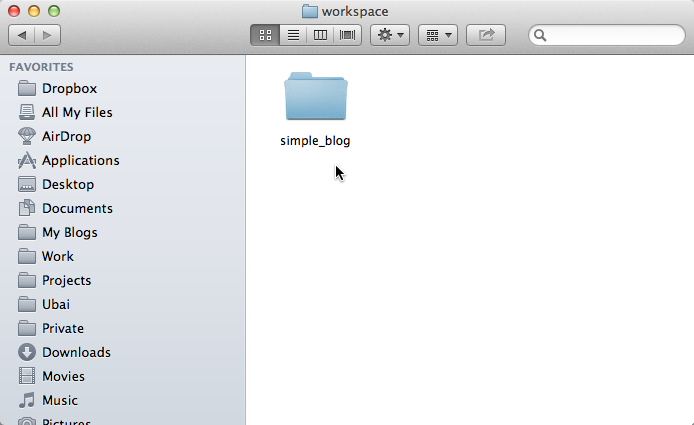

Hi and thanks a lot for your reply!
I have tried to follow your directions but unfortunately I cannot find any metadata folders with log files inside my generated Contents Workspace. Pls. see as follows my attachments and tell me if I made something wrong.
Re: 'Animation Start' has encountered a problem (on launch) [message #1062112 is a reply to message #1062103] Thu, 06 June 2013 01:40 Go to previous messageGo to next message
The dot in front of folder and file names indicates that they are hidden on Unix-based operating systems like Linux and MacOS.
Find a way to configure your file browser to show the hidden files.
Or, as an alternative, use a terminal to copy to .log file to another name without leading dot, so it is not hidden anymore.

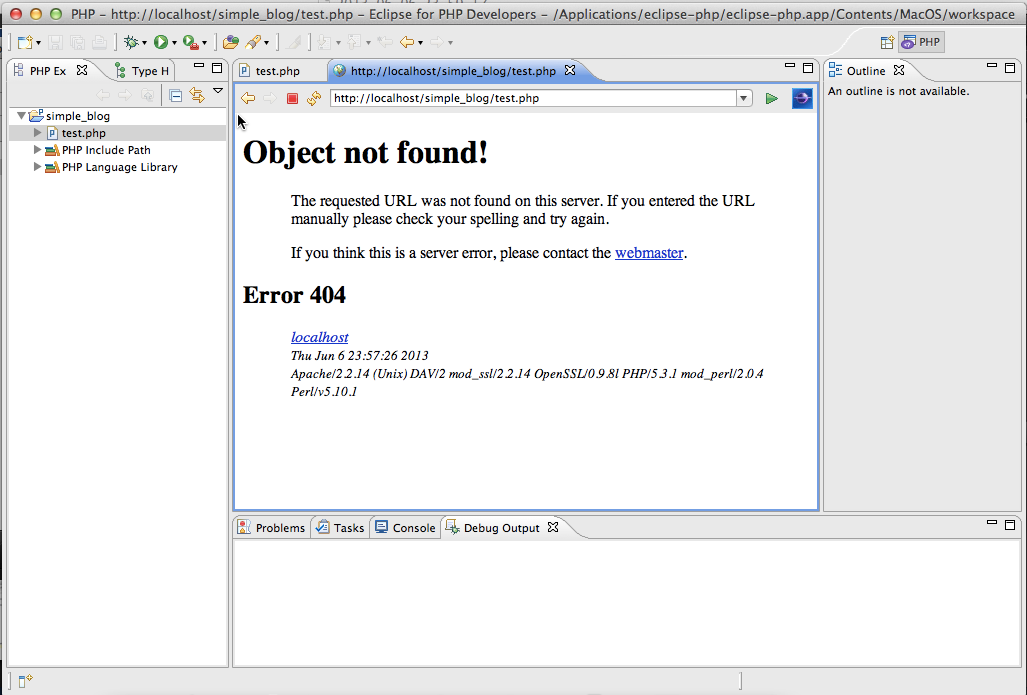

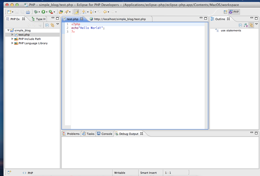

Seems I have solved the problem of the error message. Now however I have another problem. i am following the steps to learn programming of a book on php and I wrote a simple coding to test by simulating a publish in the local host through xampp. No matter how the url has not be found. I am sorry to be overwhelming but I hope you can understand the problems of a beginner. Here is what I did and what I got. Would you be so kind to explain why I cannot get a positive results? Thank you in advance for your patience
