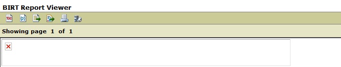

I am configuring a proxypass from DMZ to my Birt server. It is working otherwise fine, but I am missing all the images included in project. Images like navication pics that are in the viewer are loading fine. Also I am able to export the report with the images.

This is how the report loads
index.php/fa/6098/0/

If you use the /preview servlet mapping instead of the /frameset mapping
do the images come through?
Jason

Yes on preview the images load fine.

Are you setting the base_url in the viewer properties?
Have a look at these:
https://bugs.eclipse.org/bugs/show_bug.cgi?id=303453
https://bugs.eclipse.org/bugs/show_bug.cgi?id=266346
Jason

I haven't set base_url.
Joseph 2010-05-25 07:54:07 EDT on Bug 303453
There is no know way to configure BIRT so that it will work BOTH when access
directly and when accessed behind a reverse proxy.
Direct access is more important for me. Actually I can settle with the preview and pdf-format reports on DMZ-access. Maybe later setup another instance of Birt and configure it working properly from proxypass.
