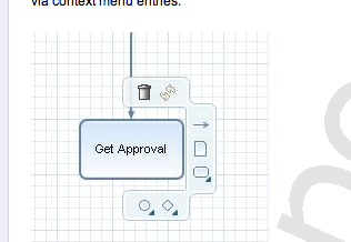

Thank you for your reply. Sorry myself new to this. Kindly clarify below doubts.
In buildContextmenu in mycontextProvider, how to add palette tools into that.
In plugin.xml
<command
commandId="someCommandId"
style="push">
</command>
what commandId need to be given and from where. And how it is being used.
Note: My requirement is to bring Palette tools into the GEF editor on user mouse click, as like GMF and graphiti ie show in attached image. Kindly refer it. Is it possible?
Thanks & Regards,
Karthikeyan.B
[Updated on: Thu, 02 August 2012 02:45] by Moderator
Re: Contributing to GEF Context menu [message #899755 is a reply to message #899712] Thu, 02 August 2012 04:41 Go to previous messageGo to next message

Re: Contributing to GEF Context menu [message #901153 is a reply to message #899823] Fri, 10 August 2012 02:38 Go to previous messageGo to next message
It is done by slightly modifying the DiagramPopupBarEditPolicy in GMF. I got that image popup. Now myself need to show the menu on left click of icons in that popup. Can anyone tell me, how to create a menu as like context menu with custom icons in the mouse left click of popup bar icons.
index.php/fa/11127/0/
Thanks & Regards,
Karthikeyan.B

Re: Contributing to GEF Context menu [message #902762 is a reply to message #901153] Mon, 20 August 2012 06:25 Go to previous messageGo to next message
Finally i achieved the above concept using PromptForConnectionAndEndCommand in org.eclipse.gmf.runtime.diagram.ui.commands package. It has been altered corresponding to GEF and used.
Thanks & Regards,
Karthikeyan.B
