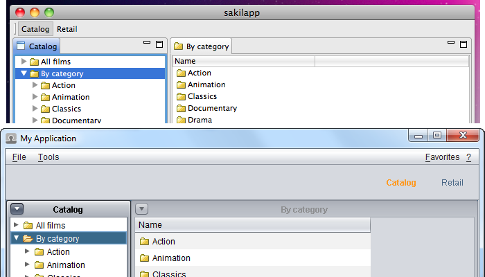

To my mind, the "outline bar", should be realized with the Main Toolbar (called Coolbar[see this tutorial: Menus and Toolbars]). All Outlines defined in the getConfiguredOutlines of the Desktop needs to be reprensented by a button (IAction). The IAction representing the selected outline should be checked.
Here a prototype (and a comparison with the Swing UI):
index.php/fa/3921/0/
