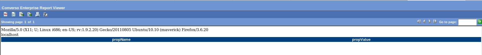

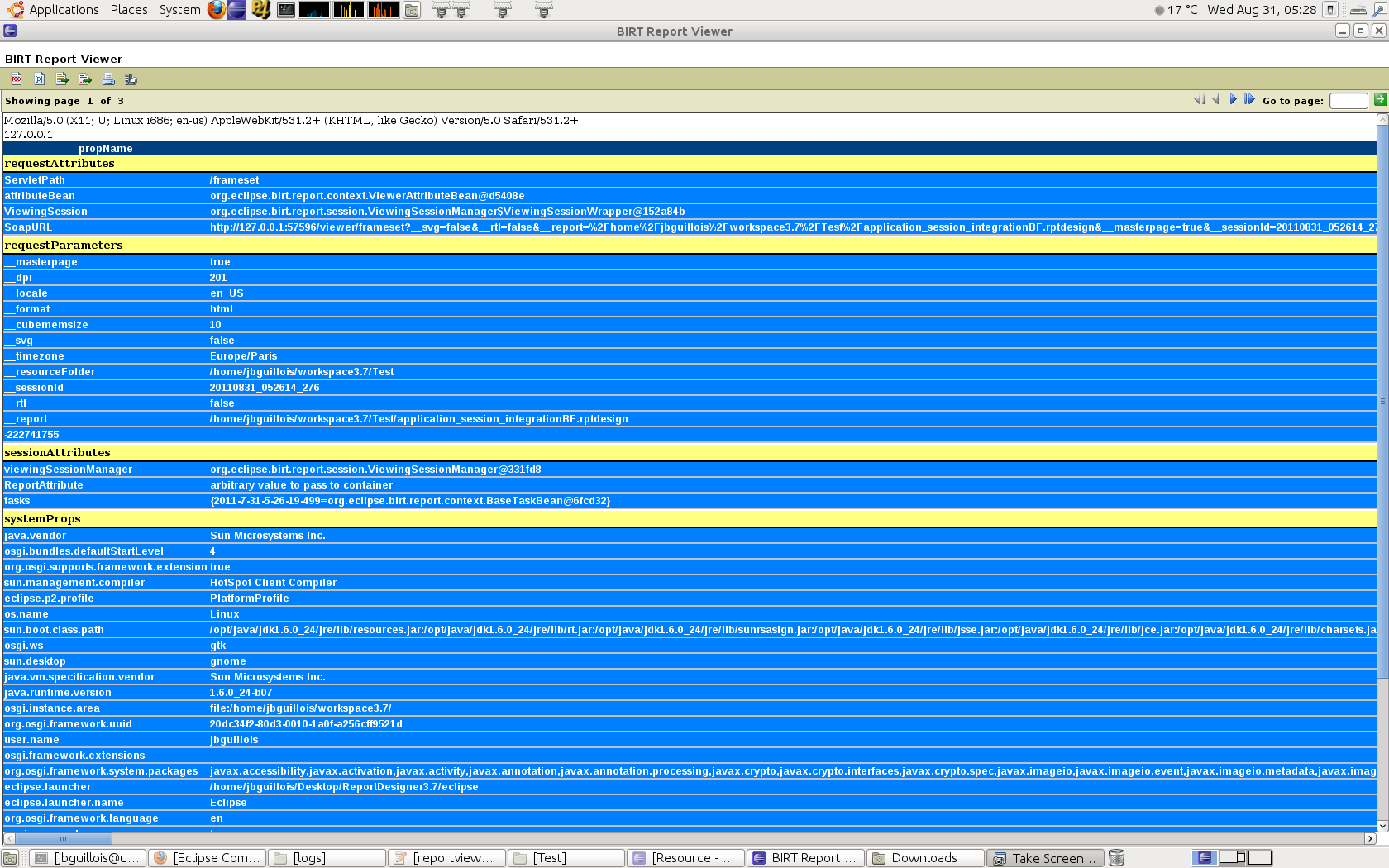

Can you try the attached report and post the results?
Jason

Re: OutOfMemory when rendering a crosstab report in WebViewer [message #721393 is a reply to message #721225] Thu, 01 September 2011 12:13 Go to previous messageGo to next message
Other than the open office emitters, why do you have all the other
emitter jars in your web-inf/lib. If you download the 3.7 run time and
look at the WebViewer/web0inf/lib you will see only one birt jar. The
open office emitter jars do need to be there but not the others. Also I
wanted to see page three of the report, to verify the jvm parameters.
How are you setting them?
Jason

Re: OutOfMemory when rendering a crosstab report in WebViewer [message #722756 is a reply to message #721393] Tue, 06 September 2011 12:07 Go to previous messageGo to next message
Hello Jason,
Sorry for the delay, i was not available beginning of this week.
I did try to remove the "other" emitters jars as you said but not better.
My JVM is started through TOMCAT with the following options:
JAVA_OPTS="$JAVA_OPTS -Xms1024m -Xmx2048m -XX:MaxPermSize=512m"
I attached the newly list of dependencies in WEB-INF/lib.
I really don't understand why even your report does not execute properly in my webapp. It seems that it can not run JavaScript or something of this kind...
Thank you for your help,
Best Regards
