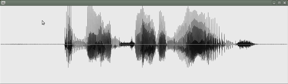

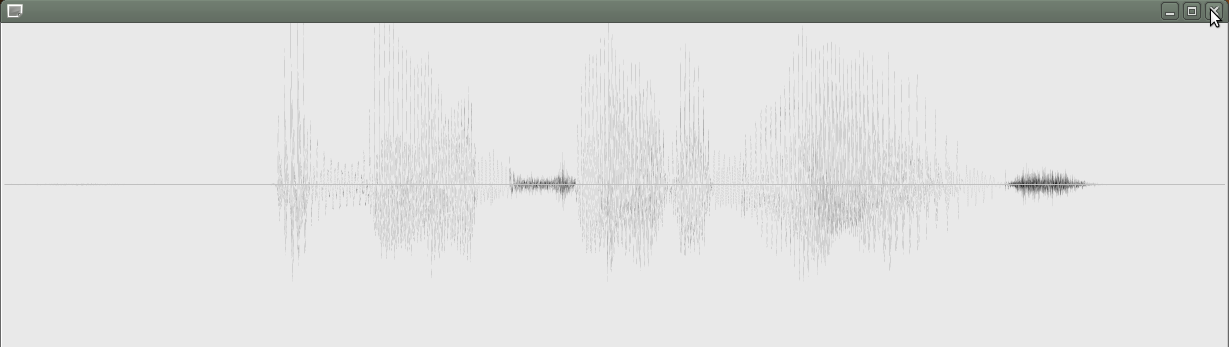

(no subject) [message #719601 is a reply to message #719475] Sun, 28 August 2011 00:03 Go to previous messageGo to next message
Tom,
Thanks for the advice.
I set double buffered (see code below). Paint duration is almost the same.
Time readings (repaint times) after resize events:
SWT (with setting linewidth) 2700ms
SWT (w/o setting linewidth) 790-830ms
AWT 2-20ms
I attached screenshots with and without setting linewidth.
Below is the code for reference.
public class WavPanel extends Composite{
public WavPanel(Composite parent){
super(parent, SWT.NONE);
this.setLayout(new FillLayout());
Canvas canvas = new Canvas(this, SWT.NONE|SWT.DOUBLE_BUFFERED);
canvas.addPaintListener(paintListener);
PaintListener paintListener = new PaintListener() {
public void paintControl(PaintEvent e) {
long t0 = System.nanoTime();
e.gc.setAdvanced(true);
// e.gc.setLineWidth(20); // faster if commented out
Transform transform = new Transform(Display.getCurrent());
transform.translate(...);
transform.scale(...);
e.gc.setTransform(transform);
e.gc.drawPolyline(waveCoordinates); // waveCoordinates.length= ~60,000
transform.dispose();
e.gc.setTransform(null);
long t1 = System.nanoTime();

Re: huge polyline performance [message #719605 is a reply to message #719475] Sun, 28 August 2011 00:21 Go to previous messageGo to next message
Tom,
Thanks for the answer.
(I sent a full post (with attachments) that seemingly got lost...)
Painting speed doesn't change considerably with SWT.DOUBLE_BUFFERED.
I post the code below.
Gabor
		canvas = new Canvas(this, SWT.DOUBLE_BUFFERED);
		canvas.addPaintListener( new PaintListener() {
//				e.gc.setLineWidth(20);  //-- lot faster if commented out
(no subject) [message #719607 is a reply to message #719475] Sun, 28 August 2011 00:03 Go to previous messageGo to next message
Tom,
AWT 2-20ms

(no subject) [message #719612 is a reply to message #719475] Sun, 28 August 2011 00:03 Go to previous messageGo to next message
Tom,
AWT 2-20ms

(no subject) [message #719613 is a reply to message #719475] Sun, 28 August 2011 00:21 Go to previous messageGo to next message
Tom,
Gabor
(no subject) [message #719617 is a reply to message #719475] Sun, 28 August 2011 00:03 Go to previous messageGo to next message
Tom,
AWT 2-20ms
