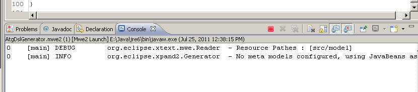

All of a sudden, i could not generate any files from the generator. Eclipse console displays the following lines for a while. Any inputs on this?
0 [main] DEBUG org.eclipse.xtext.mwe.Reader - Resource Pathes : [src/model]
0 [main] INFO org.eclipse.xpand2.Generator - No meta models configured, using JavaBeans as default.
Arun
  • Attachment: console.bmp
    (Size: 445.40KB, Downloaded 123 times)

Hi, just from this I cannot tell what is wrong, can you post your
workflow.~Christian
