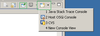

Hi Niels,
If you are referring to the buttons as shown in the image I've attached, then you should be able to test them as follows:
Any item without a drop-down list can be clicked using the normal click action (e.g. ub_grc_clickLeft_Single)
Any items with drop down lists can be tested using the module from the "unbound modules SWT" library for selecting from Toolbar Items. The action you'll need is:
ub_tbi_selectMenuEntry (either by textpath or by indexpath). The action clicks the button and selects from the drop down menu.
Hope this helps!
Alex

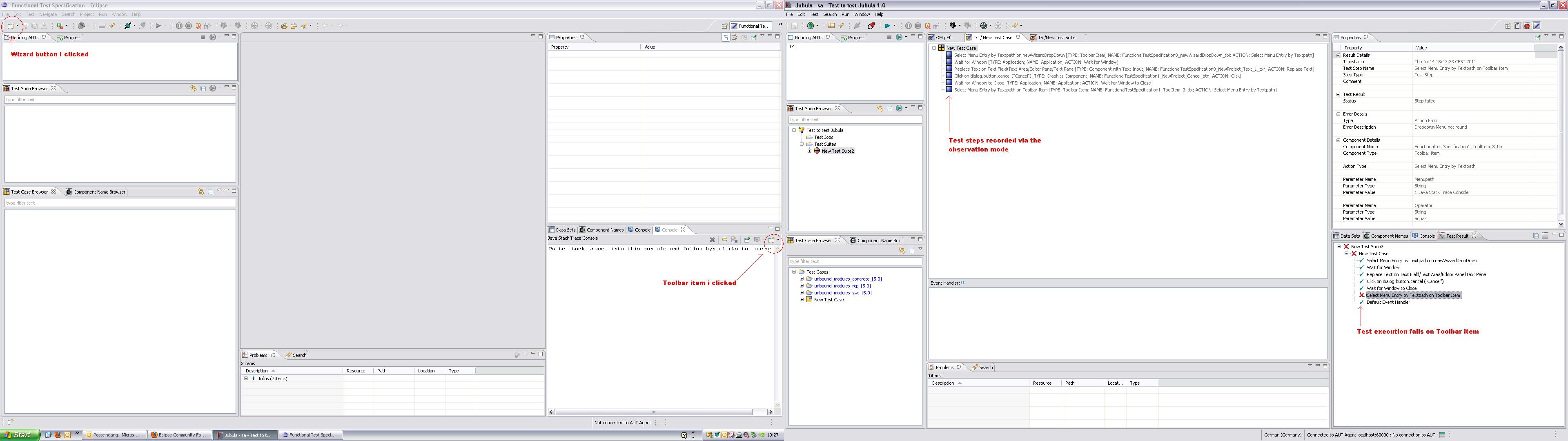

Hi Alex,
I did a very short test with a 'normal' eclipse version, not a version with my own plugins, to give a replicable reference to my problem.
I'll try to give very detailed information, maybe there a small stupid mistake I've done.
- I use Eclipse for testers (indigo version) as AUT with Jubula 0.9.0 standalone
- I Created a new test:
- I configured rcp as Toolkit for test specification as well as for AUT toolkit
- I installed the RCP plugin in Eclipse for testers
- I start the AUT via Jubula. The correct ID appers in the 'Running AUTs'-Window, in the AUT (Eclipse for testers) the 'Functional Test Specification'-Perspective is activated
- I create a new Test Case and open it
- I start the observation mode
- I did the following steps:
- Click on the 'New'-Pull-down-button in the upper left
- Select 'project...' -> The "New Project"-Window apperas
- Click 'Cancel' in the Window that appeared
- Click on the Pull-down-button in the Console-Window
(Exactly the button as posted in the picture in Alex' reply above)
- Select '1 Java Stack trace console' -> The view apperas
- I stop the observing Test Case
- I the screenshot I provied with this post, one can see the recorded steps.
- I save the test case, create a new test suite, add the test case to it, save it and start it.
- The "New"-WizardDropDownMenu is select correctly
- The test fails on the Toolbaritem (please see screenshot)
As Alex posted, it shall be possible to do theese steps. So I assume I have I small mistake, an error in reasoning or forgotten a detail of Jubula or what ever.
Any ideas or can anybody replicate this test (fail or not either way)
I'm grateful for any help.
Many thanks!
Niels
