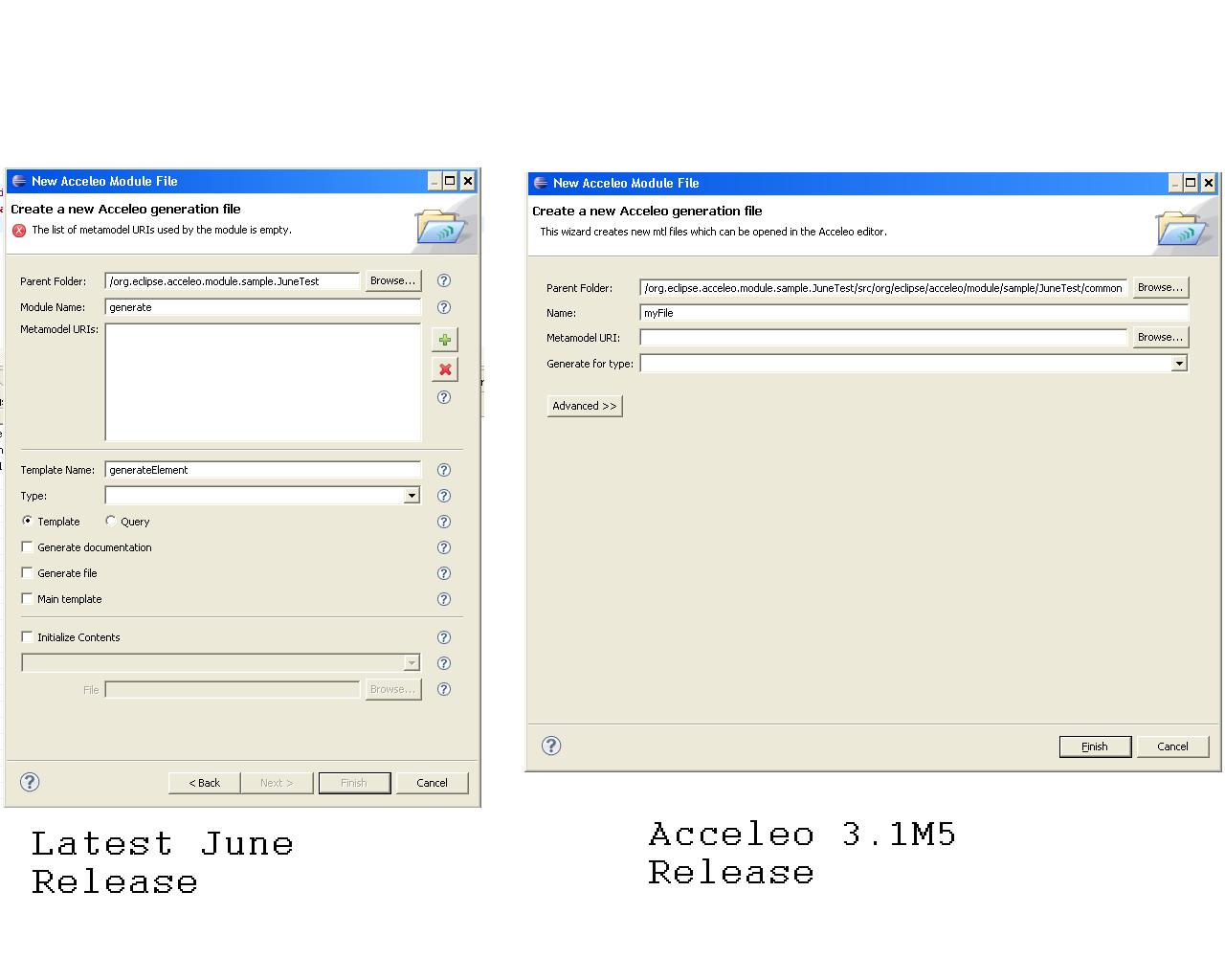

In release Acceleo 3.1M5, it was allowing to create simple acceleo module file (not main module file) without restricting user to enter metamodel uri, but in this version user has to enter that.(See Attachment) (Mandatory feature is pain)
If user is having his/her own meta model in ecore, yes that uri would not be available until he generates genmodel & code & run it as Eclipse plugin, but because in version 3.1M5 metamodel uri was not mandatory while creating module file, user can write at his own if he remembers uri without creating genmodel.
An Acceleo module without its metamodel uri is not valid. The wizard should not produce an invalid metamodel. The fact that it used to let the user produce an invalid module was the bug.
So we need to improve it to show also the metamodel in the workspace (it is not be trivial since the popup where the user select the metamodel is provided by EMF).
