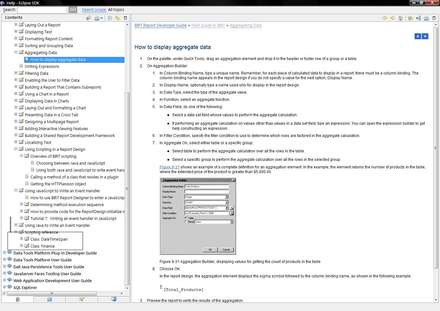

My birt designer version is 2.2.1.r221_v20070924
I know birt designer has a Total class from the following link
http://publib.boulder.ibm.com/infocenter/iadthelp/v7r0/index.jsp?topic=/org.eclipse.birt.doc/birt/birt-24-4.html
but in my report, dataset afterOpen event, I write
Packages.java.lang.System.out.println("afterOpen, Total.ave(row[\"AVG_%_Total_Processor_Time\"] " +
Total.ave(row["AVG_%_Total_Processor_Time"]));
and there is error shown in eclipsec.exe console as following

why the error message said "Total" is not defined??
also, there is computed column which called
but all return null even though row["AVG_%_Total_Processor_Time"] is not null, is this related to the "Total" class not found?

I see the help document and as the attached screen dump shown, for scripting reference, only DateTimeSpan and Finance class but no Total class, so it "Total" class not exist in birt designer 2.2.1?
