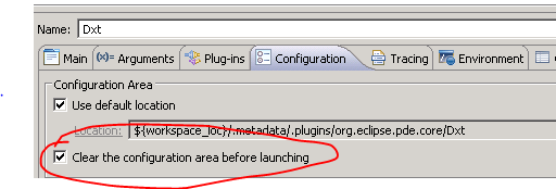

Re: java.lang.RuntimeException: Application could not be found in the registry [message #1702155 is a reply to message #683675] Mon, 20 July 2015 07:48 Go to previous messageGo to next message
I tried clearing the configuration before run and it worked !
