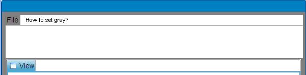

Re: MenuBar background color [message #1031196 is a reply to message #676711] Mon, 01 April 2013 06:40 Go to previous messageGo to next message
Hi, in my RAP aplication (RAP 2.0) I'm create menu by use next extension-point
<extension
point="org.eclipse.ui.menus">
<menuContribution
locationURI="menu:org.eclipse.ui.main.menu">
<menu
label="File">
<command
commandId="org.eclipse.ui.file.exit"
label="Exit">
</command>
</menu>
</menuContribution>
</extension>
then in my css theming use next
MenuItem {
background-color: gray;
Shell {
How I can set background color for all menu?
Thanks, Anatoliy

Re: MenuBar background color [message #1032001 is a reply to message #1031196] Tue, 02 April 2013 09:04 Go to previous messageGo to next message
Hi Anatoliy,
the menu bar is a Menu. You could try:
Menu {
HTH,
Ivan

Re: MenuBar background color [message #1032527 is a reply to message #1032001] Wed, 03 April 2013 01:22 Go to previous messageGo to next message
In my case it work:
Toolbar{
Thanks, Anatoliy
