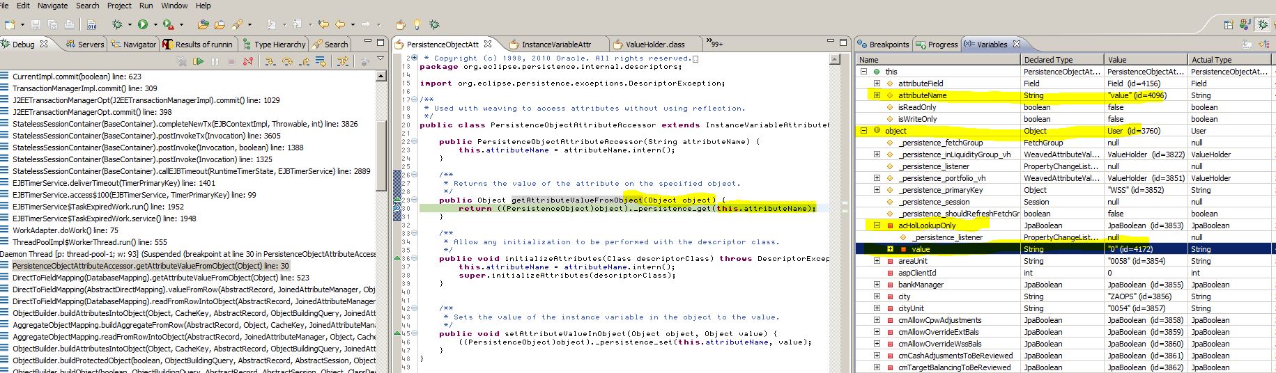

We have just moved over from toplink to eclipselink, and none of our embedded objects are being correctly populated on calls to em.find() (maybe others to). When debugging I can see that the correctly populated object has been returned from the db (and is in a cache?), but when building / copying/ cloning that object to return to the caller of em.find() it is failing to pull the value out of that object into the returned object. It appears that in here
(org.eclipse.persistence.internal.descriptors.PersistenceObjectAttributeAccessor.getAttributeValueFromObject(Object) ):
    public Object getAttributeValueFromObject(Object object) {
        return ((PersistenceObject)object)._persistence_get(this.attributeName);
the object passed in is the object containing the embedded object, yet this.attributeName is name of the field in the embedded object - in this case 'value' and returns null as there is no attribute named 'value' in the object passed in. I can only see that it would work if the embedded object itself was passed in, or if the attribute name was name of the embedded object.
in the calling method next down the stack frame the direct to field mapping is org.eclipse.persistence.mappings.DirectToFieldMapping[value- - >WSSDBA.WBR_USER.ACHOLLOOKUPONLY].
Something is not quite right with the weaving or something elseewhere, has anyone seen anything similar ?
Eclipselink 2.2.0.
I am trying to reproduce this is a standalone app/ ear but not having much look reproducing in such a scenario.
this	PersistenceObjectAttributeAccessor	PersistenceObjectAttributeAccessor  (id=4134)	PersistenceObjectAttributeAccessor	4134
	attributeField	Field	Field  (id=4156)	Field	4156
	attributeName	String	"value" (id=4096)	String	4096
	isReadOnly	boolean	false	boolean
	isWriteOnly	boolean	false	boolean

Daemon Thread [p: thread-pool-1; w: 93] (Suspended (breakpoint at line 30 in PersistenceObjectAttributeAccessor))
	PersistenceObjectAttributeAccessor.getAttributeValueFromObject(Object) line: 30

  • Attachment: el_vars.JPG
    (Size: 290.48KB, Downloaded 492 times)
Re: EmbeddedObjects - fields not populated correctly [message #670010 is a reply to message #670009] Thu, 12 May 2011 08:11 Go to previous messageGo to next message
the resulting object from em.find() is as below - where the embedded object has a value field of null instead of "0" as in the object shown above

Re: EmbeddedObjects - fields not populated correctly [message #671556 is a reply to message #671510] Wed, 18 May 2011 06:01 Go to previous messageGo to next message
Ok - still on 2.2 at moment - same behavour with static/dynamic weaving- with weaving turned off altogether though an exception is thrown as below. Now to try latest eclipselink

My guess is it is probably related to caching or your usage of your objects in your persistence context.
You could try disabling caching by setting shared to false, to see if that is related.
Also ensure you are not reusing the same aggregate for many owners, and ensure you are not mixing managed and detached objects in the same transaction.
Re: EmbeddedObjects - fields not populated correctly [message #673603 is a reply to message #671940] Tue, 24 May 2011 04:36 Go to previous messageGo to next message
Yeap - this is down to caching somehow - if I comment out all eclipselink.cache.shared.entityName=false properties in the persistence.xml then all is well, if I put the property back in for an entity that has no embedded objects in then it is still ok, as soon as I put the property back for an entity with an embedded object referenced somewhere in that class/ superclass/ referenced class then it fails for everything that also has a reference to that same type of embedded object. BUT cant reproduce in a standalone ear no matter how hard i try...... same occurs in 2.2.0-rc3, 2.2.0, 2.3.0-rc1. The exact same thing under toplink has no issues. We must have some odd config somewhere
Re: EmbeddedObjects - fields not populated correctly [message #673747 is a reply to message #673603] Tue, 24 May 2011 11:45 Go to previous messageGo to next message
Are you mixing shared and none shared cached objects? i.e. do you have a reference from a shared cache object to a shared=false object?
This could be an issue with our new protected cache support in 2.2. Please log a bug for the issue with as much details as you have.
Can you try the 2.1 release, does it work in that version?
Does it work with the shared cache off for everything?
Re: EmbeddedObjects - fields not populated correctly [message #673999 is a reply to message #673747] Wed, 25 May 2011 09:32 Go to previous messageGo to next message
yeap - that's it - if I have just
<property name="eclipselink.cache.shared.Country" value="false"/>
then it fails , if I have
<property name="eclipselink.cache.shared.default" value="false"/>
<property name="eclipselink.cache.shared.Country" value="false"/> <--- redundant
then'its ok - ie the same as if no eclipselink.cache.shared.EntityName=false entries
will try with the different versions and file a bug report with a matrix on how it behaves...
Re: EmbeddedObjects - fields not populated correctly [message #674026 is a reply to message #673999] Wed, 25 May 2011 10:55 Go to previous message
see https://bugs.eclipse.org/bugs/show_bug.cgi?id=347168
