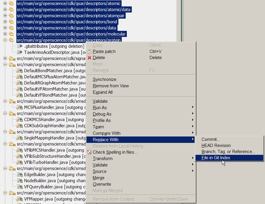

I have occasionally removed the folder in my workspace (from command line, not from Eclipse).
EGit shows the outgoing changes, but I am not able to revert them (I tried "Replace with" → "HEAD" and "Replace with" → "File in Git Index" in Synchronize view). No reaction. Does it have something to do with https:/bugs.eclipse.org/bugs/show_bug.cgi?id=345002 ?
Is there any way for me to recover / revert?

Git doesn't track directories (folders), so it doesn't really make sense to run an egit file operation like Replace With on a directory. You need to re checkout the deleted directory to get it back -- that's the command-line Git fix.
Not sure how you'd do it in egit, since it doesn't seem to support 'checkout' at the path level. If you have no other changes you can always use the egit 'reset' operation to reset the repository as a whole. Or you might be able undo the damage from the "Git Staging Area" view.
Re: How to discard file modification [message #715750 is a reply to message #714943] Mon, 15 August 2011 08:00 Go to previous messageGo to next message
Confirming after some experiments that there doesn't seem to be any way in egit to restore a deleted directory, short of a hard reset of the repository. Note that this situation also applies if you delete the directory from within Eclipse, it's not specific to doing the delete externally.
Is there some way to do this, other than a reset, that I'm not seeing? Obviously a reset is no good if there are other other un-commited changes.
If there is no other way, egit probably needs one. The most general solution would seem to be an optional path in the egit 'checkout' dialog. That would be useful for other situations as well and corresponds closely to the standard command-line Git fix.

Continuing with these experiments, there's good new and bad news.
Good news: you can generally restore deleted files, and the containing directories, via Restore From Local History. Obviously this depends on your Local History preferences and the specific context in which you try to restore after a delete. Using command-line git is probably easier, especially with Terminal view, and certainly more reliable. But if you don't have command-line git and you act promptly, you can probably restore your deleted files this way.
Bad news: all the previously mentioned issues regarding deleted directories also apply to individual files, even when the containing directory still exists.
I tried deleting a single file to see if Git Tree Compare would show the deletion. It does not. Worse, the parent directory does not have the expected '>' decoration. Thus the Explorer view gives me no indication whatever that I have an un-commited modification. The deletion is listed as a Staged Change in the Git Staging view, but I can't undelete from there. I can un-stage it -- that's as far as I can get using egit. I cannot replace the file from the Index. To undelete without a hard reset I need to depend on on Local History, or resort to command-line git.
